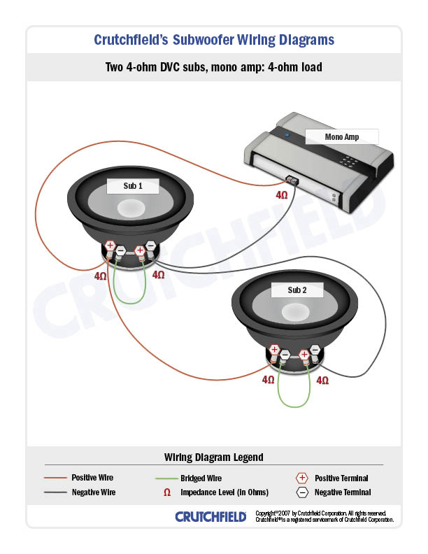

Thanks again.. I mis-read the max RMS as the peak. But, wouldn't I want to go higher in power then, as if wiring @ 4ohm, that would only be delivering 250w per sub?. Much appreciated. I started checking out the DIY Mobile site, too.
Not sure I'm following the question.
Basically the rule of thumb is you want to add the 2 subs RMS wattage together and Target that as your amplifier RMS. You then need to match the impedance 4 ohm or 2 ohm and find an amplifier that can do that at one of those final impedances. So looking at that amplifier and the RMS rating for the id10s we see that to reach the 500 watts RMS you would need to have a final impedance at the amplifier of 4 ohms. Jumping to a final impedance of 2 ohms will take you to the 800 RMS which is probably too much for two of those subs to handle.
Hopefully that makes more sense around the wiring recommendation. When looking at amplifiers it's better to think about the RMS values than the maximum values. Most Max values can only be achieved under the most ideal of conditions meaning distortion-free signal in a full 14.4 volts provided.

Got it. I thought I needed to have enough power to get as close to the max wattage as possible, without exceeding, as not to underpower the subs. I was looking at it wrong. Once again, thank you for the education
Yeah, MAX is a bad word when planning audio. It's marketing hype. That's why you'll see a boss sub with a 250w RMS say something like 1200w max.. It's just not going to happen.
Only look at RMS like he mentioned.
Sub 1 RMS + sub 2 RMS = amp RMS
You can go about 10 to 20% higher with the amp as long as your gain is set properly.
Check this out, it's helpful for planning and how to wire.
Example pic attached.
