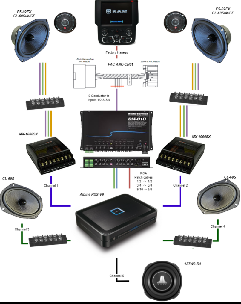

This is kinda the route taking. I'm getting the signal thru a modified ANC-ch01 and sending the hi-level front signal to a D-4.800 for a front set of Morel comopnents, RCA output from that amps DSP to A LC-1.800 for a sub (TBD). The Radios rear channels go to a ACM-2.300 feeding a pair of morel 6x9 coaxial speakers to get me rear fill and some more volume. Just need the time to install it all and decide on what sub to go with. I was thinking a old round SOLO 12 that I have but a pair of Q class 8's and an MBE enclosure has peaked my interest lately
I'm heading the same route with my install whenever the temperatures get reasonable around here again. Are you running all new wiring or utilizing the factory harness?

I am under the impression that the dash speakers are directly drive off of the head unit and dont go to the ANC. My plan is to unhook them all together and put the tweeters from my MOREl set in the door sail
Gotta add wires for the front doors so I can individually feed the tweeter and midbass drivers. I have a 25x44 shop to do the install and a box full of all the parts (unless I do the Q class 8s). Just no time. Im expecting the truck to be down for a couple days. Going to also do the passive entry and dynamat at the same time so I'll have to pull most of the interior
