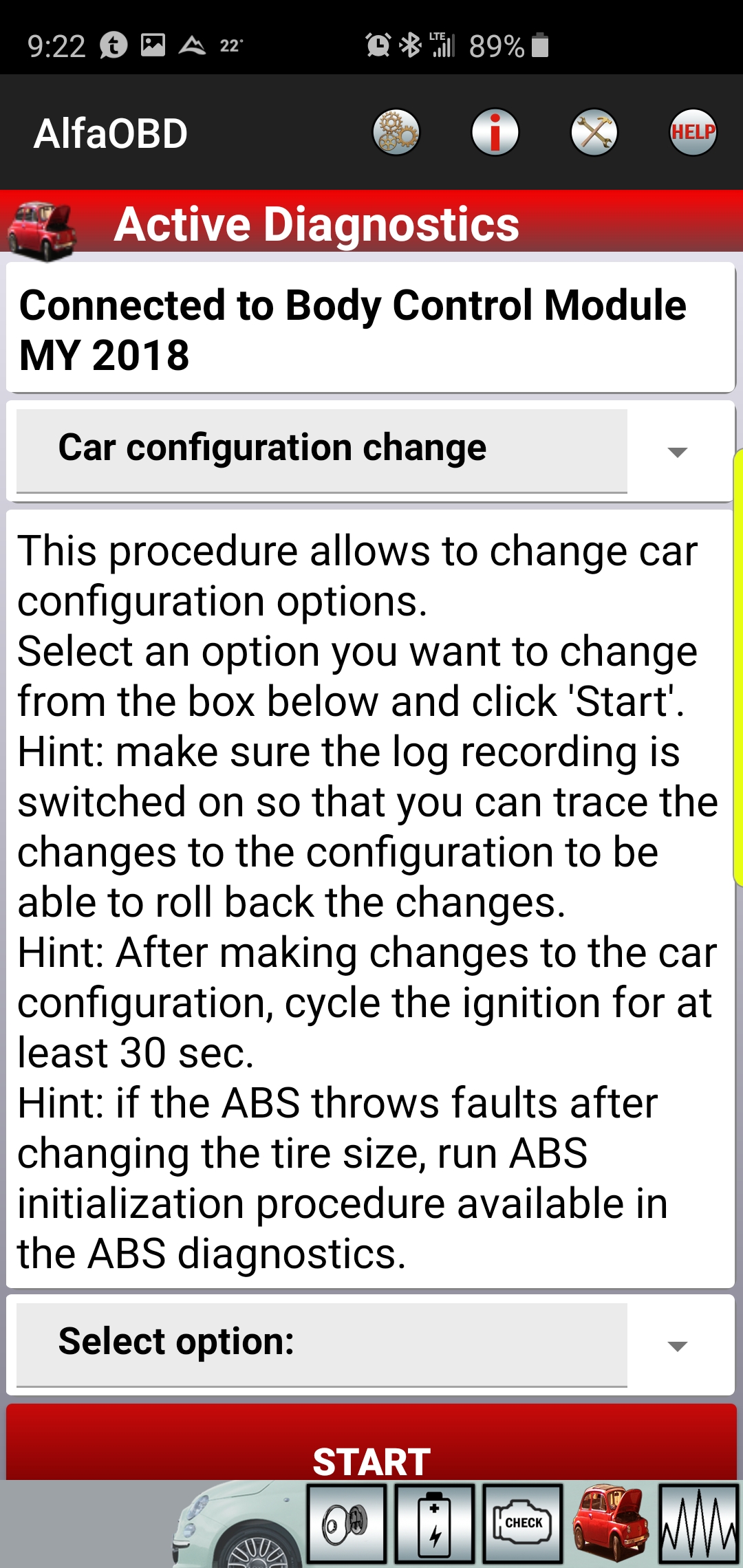

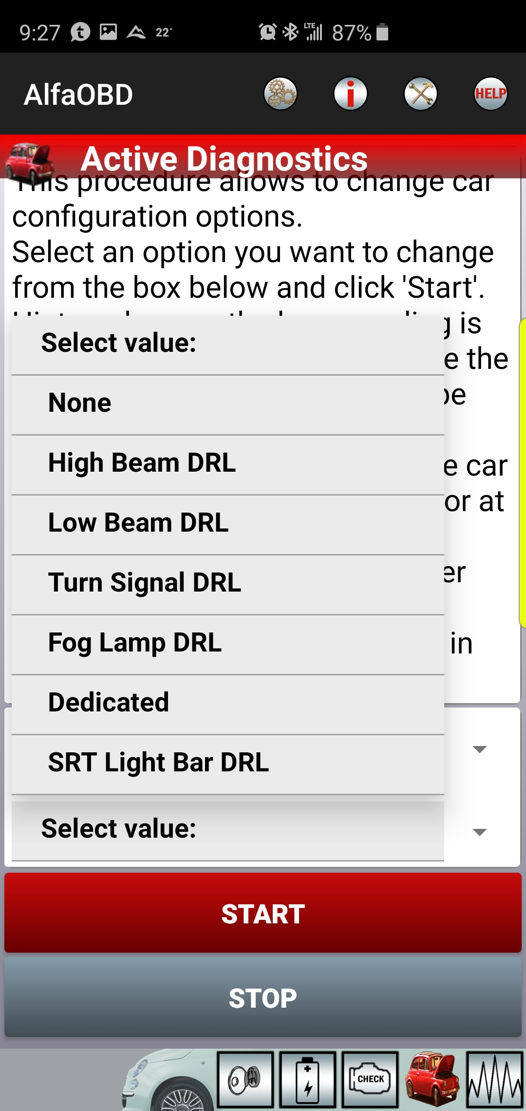

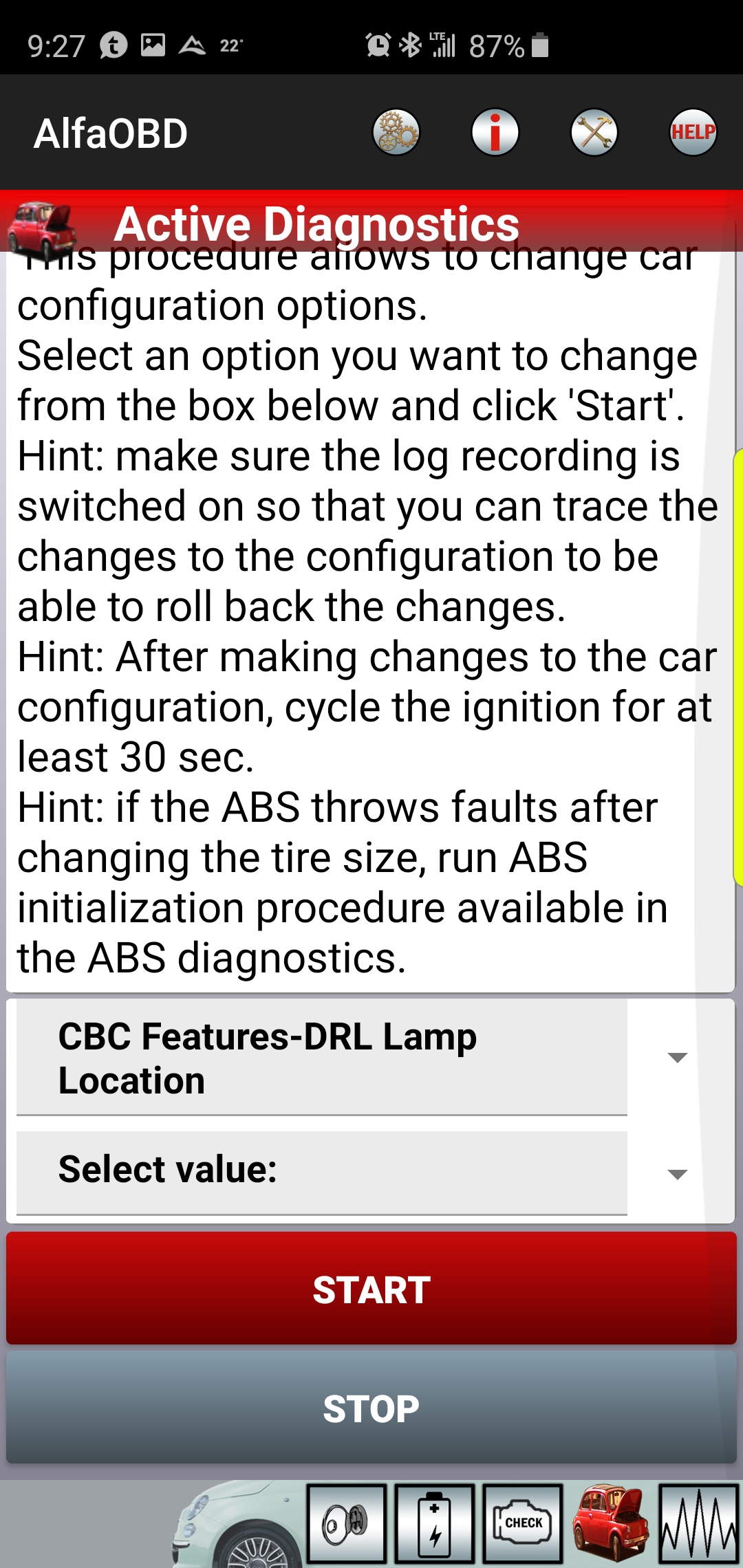

.I have changed fog light drop out and DRL source to Amber lights vs LED.
Do you remember where you found the ability to change the DRL Source? Did is say DRL Source, CBO something else?
Thanks,
Tim

This was answered for me elsewhere, but I'll add it here, too. The PIN is not required to alter the BCM. It is required to modify some other things.
I purchased AlfaOBD, the SGW bypass, and the OBD interface, and was able to turn on my trailer brake controller and theft alarm.
Still experimenting...
Do you have the new body style? "DT"
