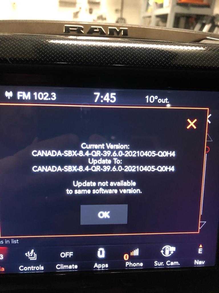

Something strange also happened to my 8.4 Nav today. Updated to Qr 39 a few days ago and enabled off-road and performance page with Alfa and today they disappeared. Haven’t gone out to the truck yet to try again with Alfa. Just found it strange that it is all gone.

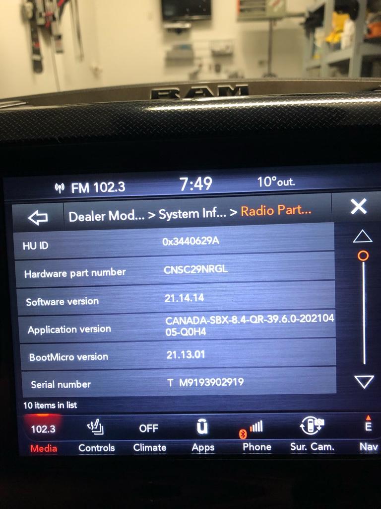

Check your current application version before you do that.
So just did some checking. Application version is the same as what I installed the other day with the update.
Used Alfa to turn off - off road pages, off road capability and performance pages.
Sent two radio ECU resets
Reconnected to body module and enabled off road pages and off road capability.
Still have no off road pages are still missing. This is strange.
* Also cleared any codes in the BCM and radio. Sent two more radio ECU resets and still no luck.

Ahh, shoot. I sent someone to you for the update and it didn't occur to me that you were in Canada. Apparently, the US and Canadian software is different. Your screen name should have tipped me off. 🙄

I’m on QR 39.62 with my 8.4 Nav unit and the Uconnect site says my truck is up to date.

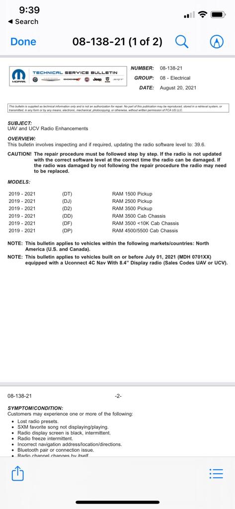

The FCA documentation says for UCV and UAV, It states at the bottom of the page for North America - US and Canada
So it should work for everyone.

@WhiteKnight4x4 no need to try and install the software. Unfortunately, It is not compatible with our trucks.
While the TSB is for North American 8.4" NAV trucks (both north and south of the border) his software update is only for the UCV (Canadian) radio units. It does not work for us Yanks with the UAV 8.4" NAV units. The filename has 'UCV' in the title but tried anyway and got the software incompatible error message.
