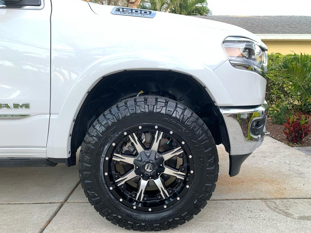

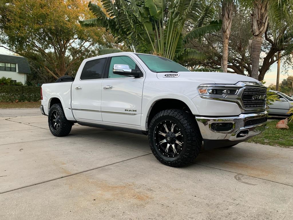

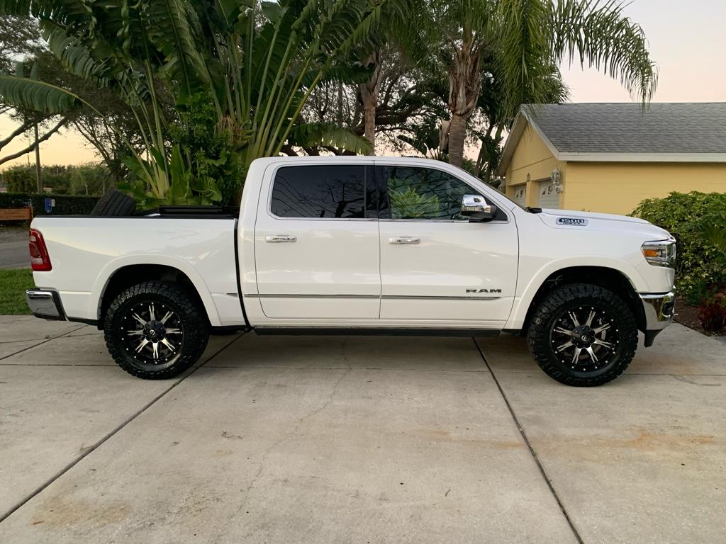

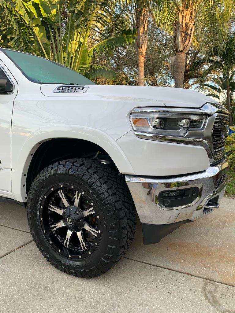

Mine is sitting about 41 fender to ground in the rear and 40.25 in the front. So I’ve got just the smallest bit of rake still. I might adjust it some more, but I figure I’ll let everything settle and see how it is in 1000 miles.
Fuel Nutz 20x9 wheels with 285/65/20 Nitto Ridge Grapplers.
Nice setup, got a similar 1500 ordered. What is your wheel offset?
