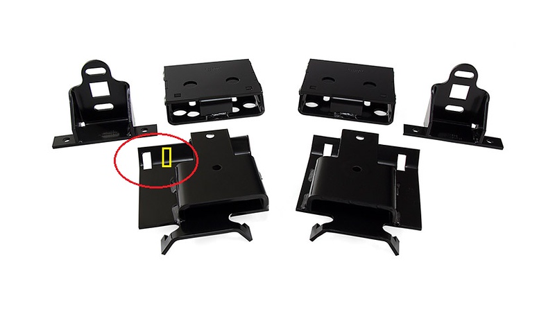

FYI, the install isn't as simple as their install video makes it seem. Cutting off the upper bumpstop mounts was very tight, but a die grinder did the trick. I cut off one side and was able to bend/pry the upper mount off without too much hassle. The rest of the install went smoothly except for one thing....it was here I ran into my first problem. On the driver's side, the lower Air Lift bracket mounts to the axle's bumpstop pad. Well, one of the holes lined up....the inner one. Here's a pic:
And the rear bracket "tangs" were properly placed, as well:
The problem was that the holes didn't line up for the bolt on the outside of the bracket. Here's a view from the top. The slot is where the carriage bolt is supposed to go. The yellow image that I so cleverly added is approximately where the slot would need to be in order to work with my truck:
It's tough to really see it, but this is where the slot should be located. This is looking up from the bottom through the axle's lower control arm bracket.
And another shot where the problem lies:
Air Lift did not know this (nor did I), but evidently the bump stop pads on the axle are a bit different on a Rebel compared to a non-Rebel. They told me it would be just fine running only the 1 bolt, but that doesn't sit too well with me. I bought a long drill bit and will try to add the 2nd bolt before I tow with it. So that's issue #1.
