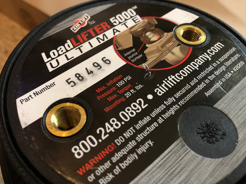

First of all, the PN listed in the manual for the bags is different. Ignore that. The PN in the manual is for the "kit" of two bags. This is the PN you want to see on your bags:

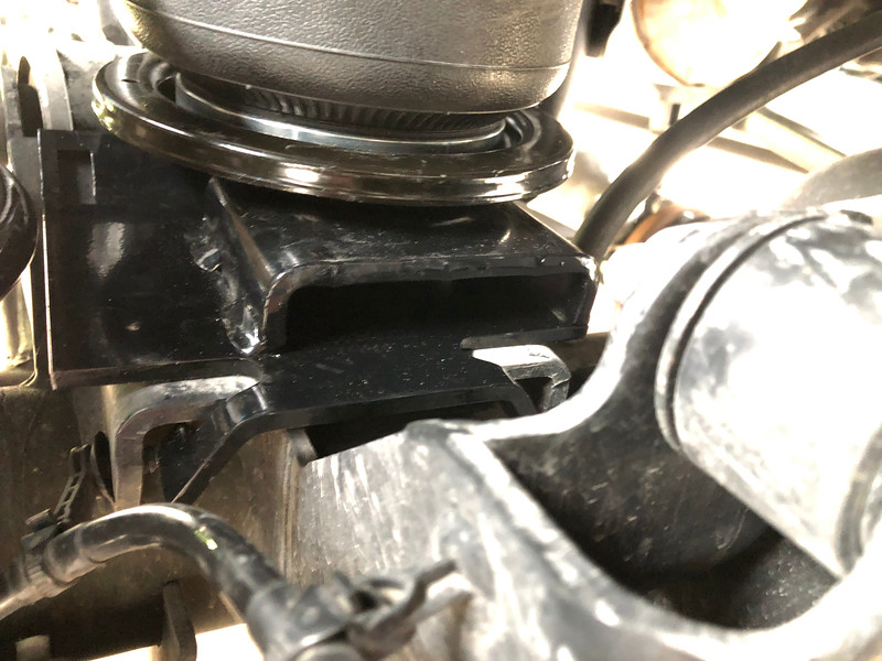

And the rear bracket "tangs" were properly placed, as well:

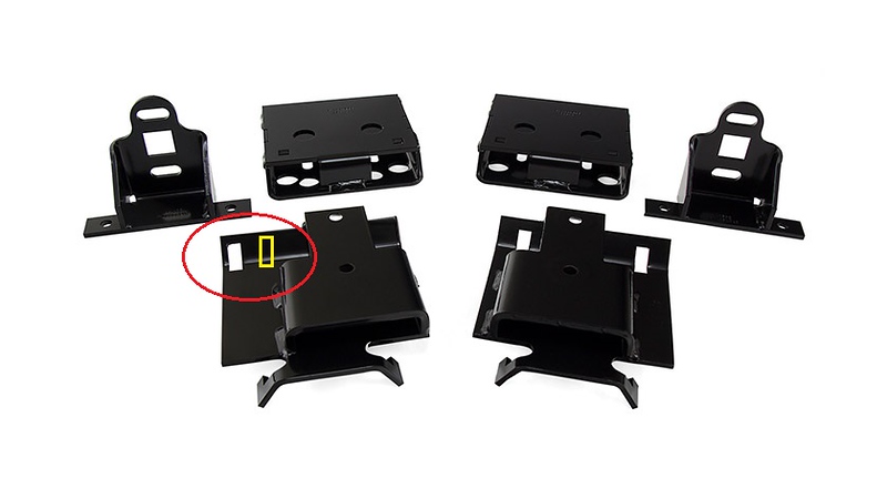

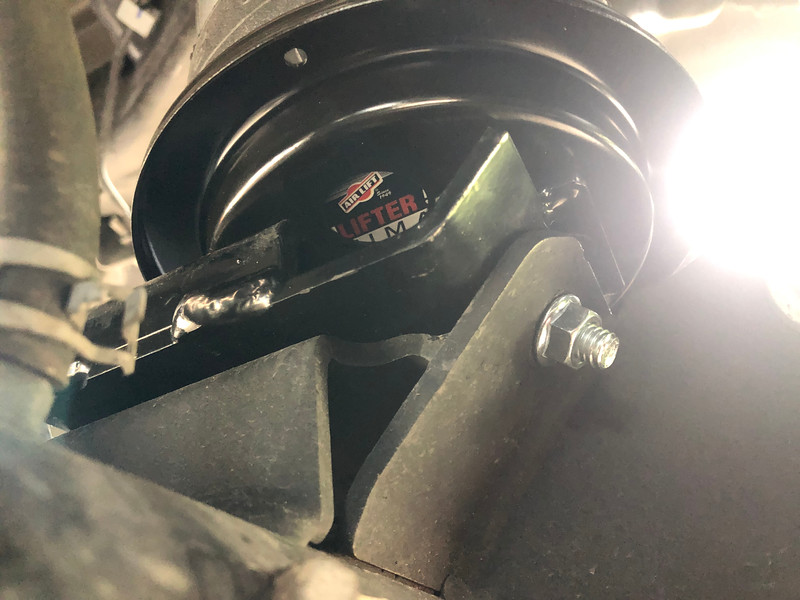

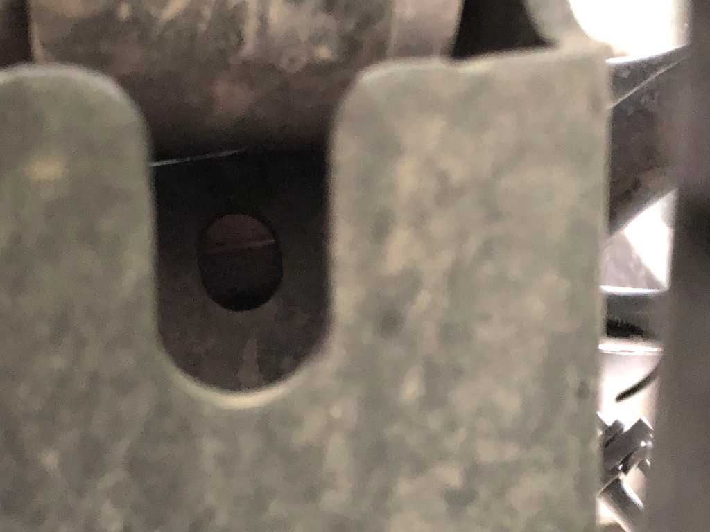

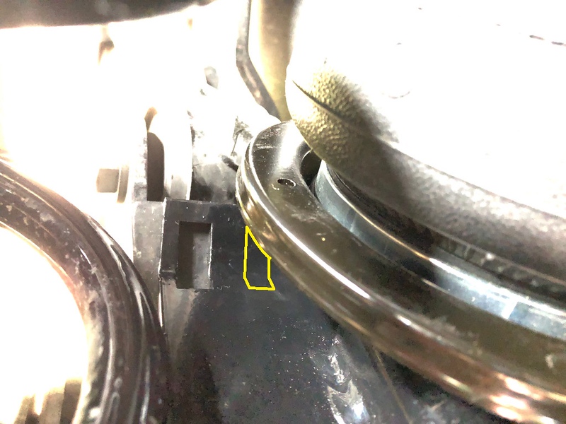

The problem was that the holes didn't line up for the bolt on the outside of the bracket. Here's a view from the top. The slot is where the carriage bolt is supposed to go. The yellow image that I so cleverly added is approximately where the slot would need to be in order to work with my truck:
It's tough to really see it, but this is where the slot should be located. This is looking up from the bottom through the axle's lower control arm bracket.
And another shot where the problem lies:
Air Lift did not know this (nor did I), but evidently the bump stop pads on the axle are a bit different on a Rebel compared to a non-Rebel. They told me it would be just fine running only the 1 bolt, but that doesn't sit too well with me. I bought a long drill bit and will try to add the 2nd bolt before I tow with it. So that's issue #1.

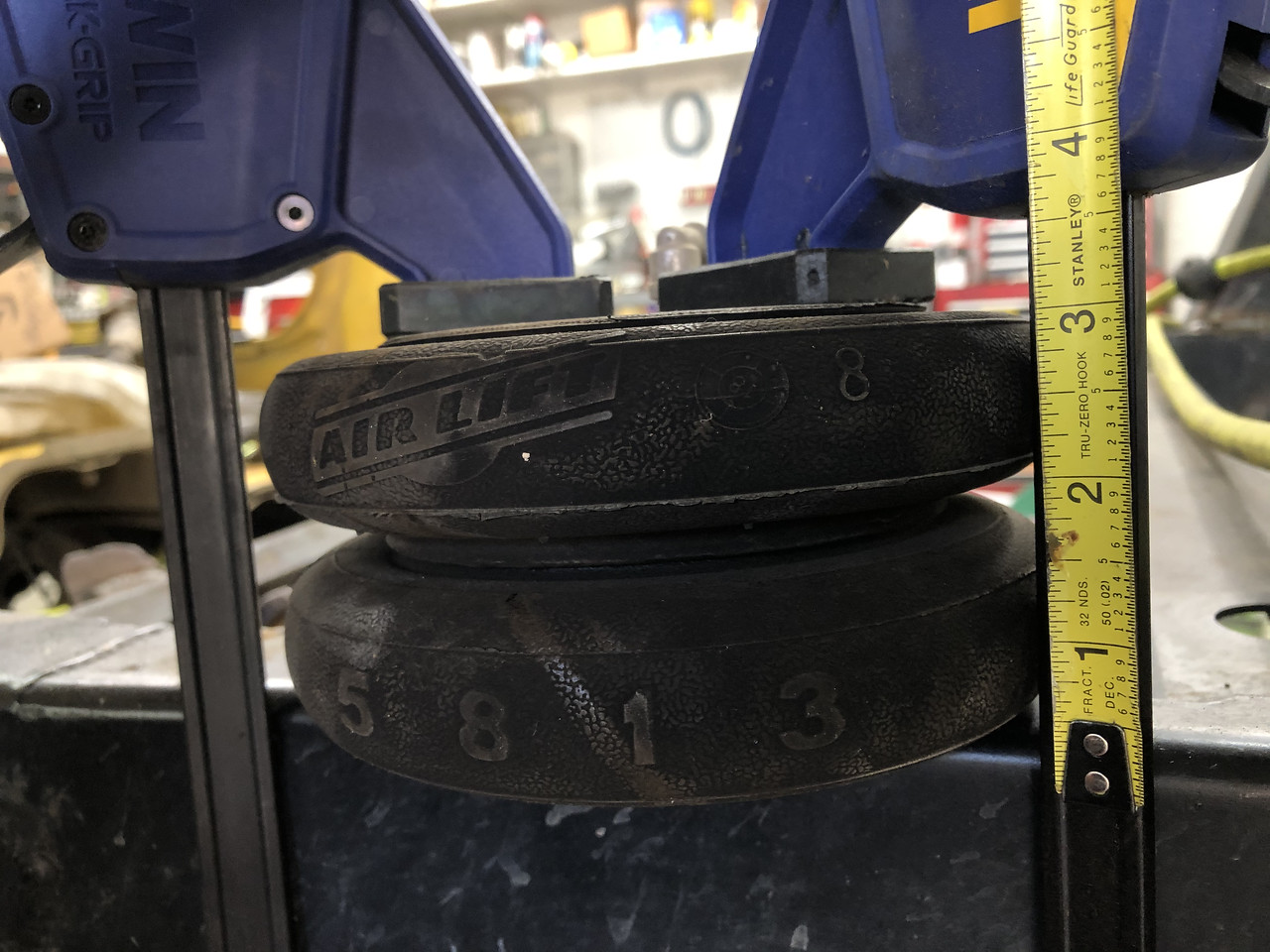

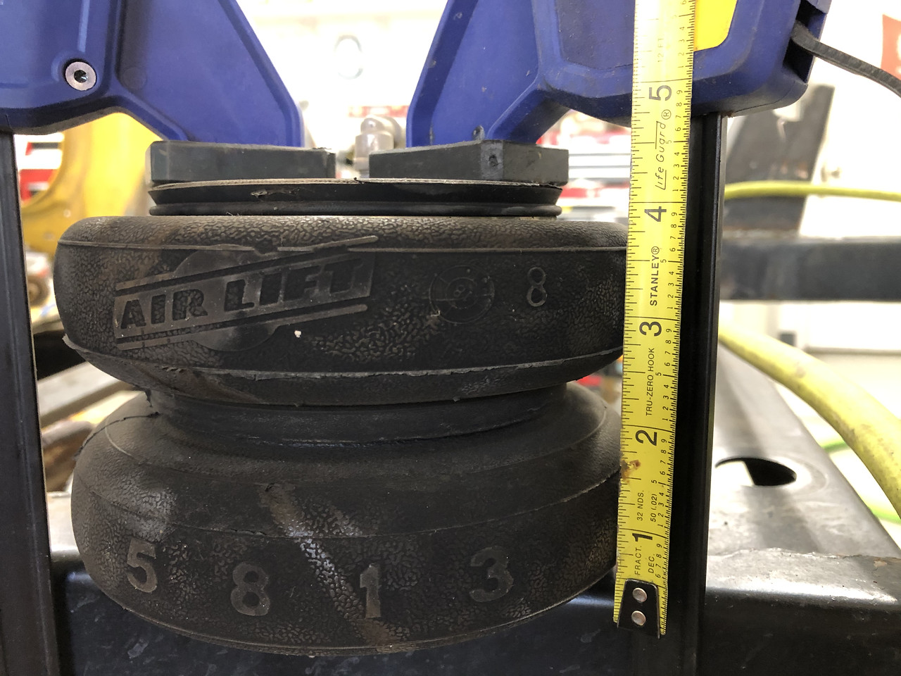

Here is the original airbag compressed until the bumpstop begins to engage. Roughly 4.5".
Continuing to compress the bag and it'll squeeze the bumpstop until it reaches a fully compressed height of roughly 3".

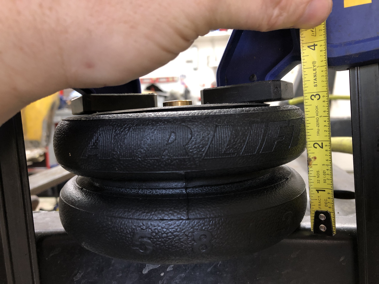

Here's the new air bag (without internal bumpstop), which compresses to the same 3" as the original, but it does so without first compressing the bumpstop.
So how does the truck ride now? Well, it's much better now! If I run at the minimum 5 psi I'll occasionally feel the suspension bottom in the rear. Yes, it's still annoying, but it's so much better than before. I suspect the issue is that the upper and lower brackets of the Air Lift system are simply too tall. If those could be reduced, it would increase the available bump travel quite a bit. For now I'm reasonably content, but for the money I'm disappointed Air Lift didn't do a better job on this.
