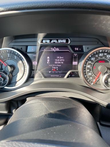

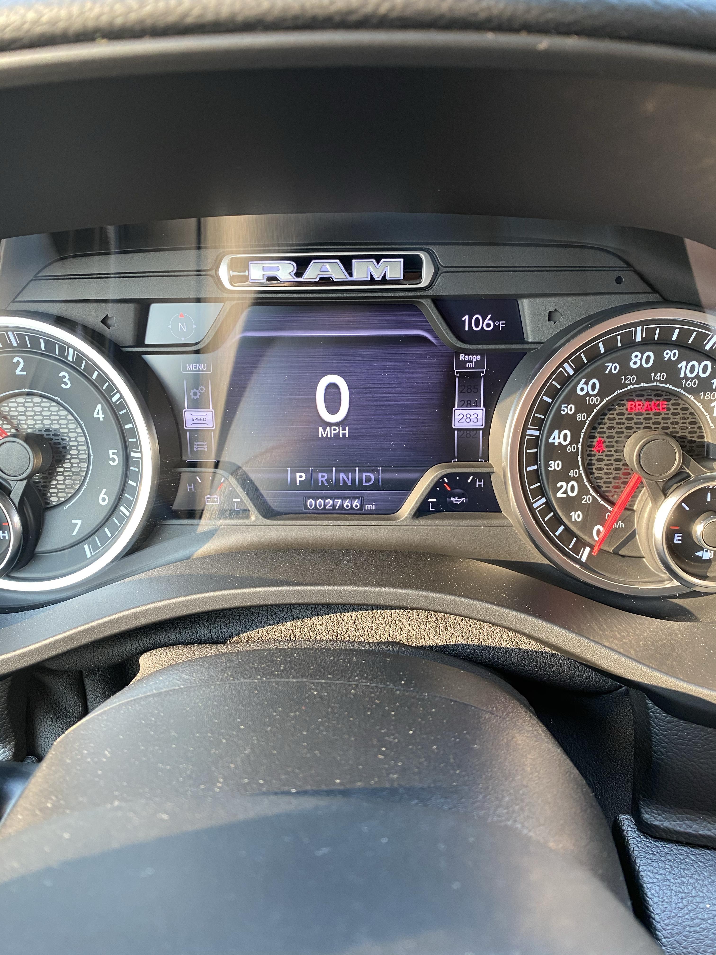

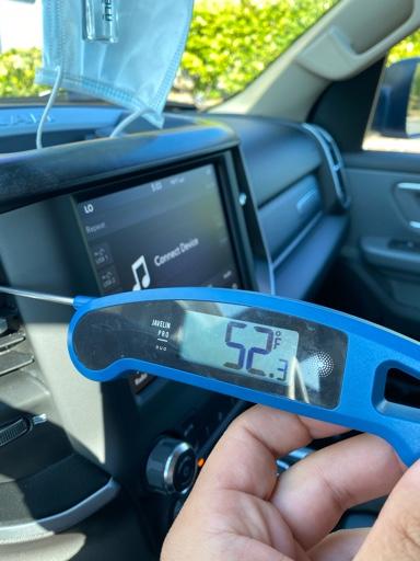

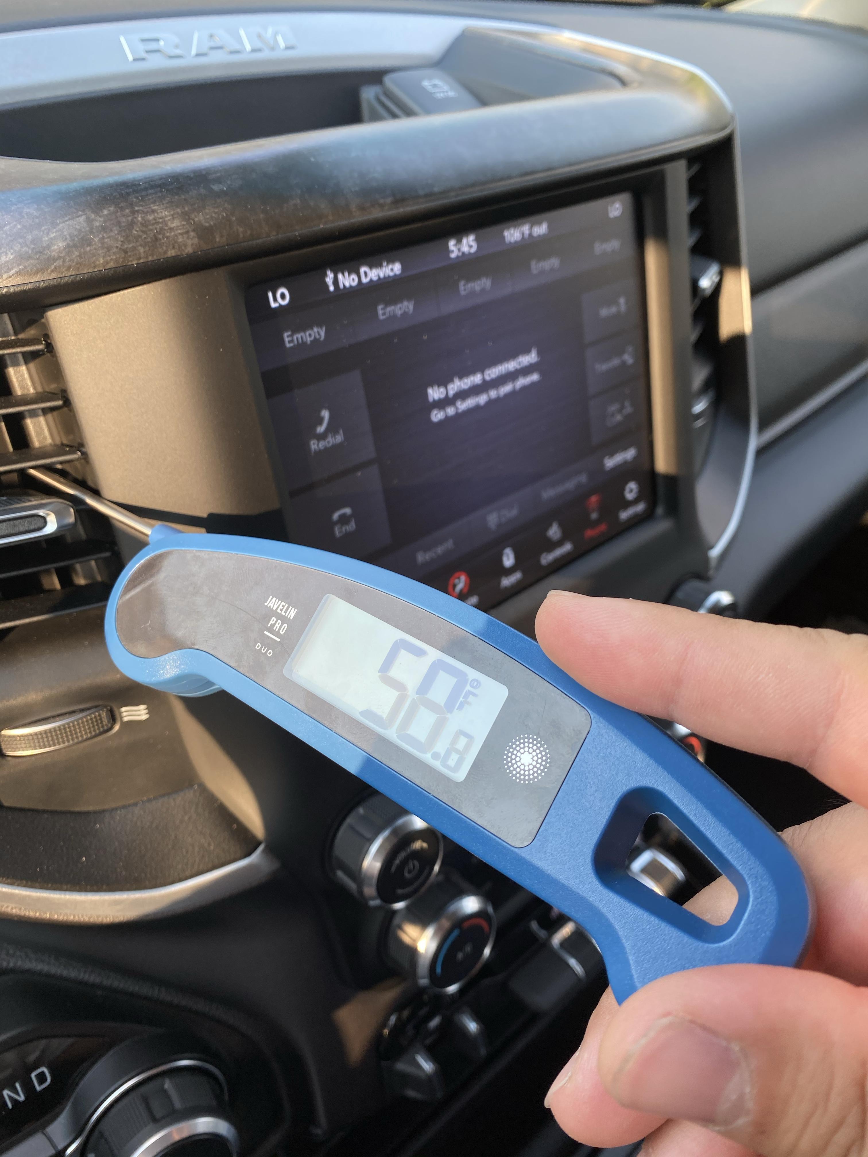

Test was done after the truck was driven for 15 minutes in “Max A/C” mode.
The vent temp will always be relative to the outside temp. In my situation, it is a 48 deg drop from ambient, which is pretty damn good from an academic perspective...and is perfectly within spec for FCA.
However, I think customers always expect more, but how cold is cold enough? What is a reasonable expectation?
