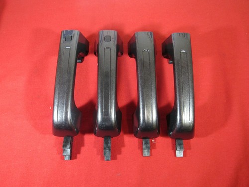

Found this on eBay, It's a good deal imo...

Yeah... I couldn't find part #s for the 2500s... Can you post a picture of your handle? I'm pretty sure it's the same as the 1500 but the parts websites only show the older version...
