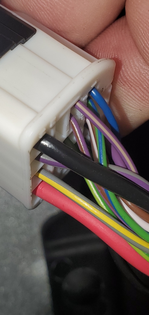

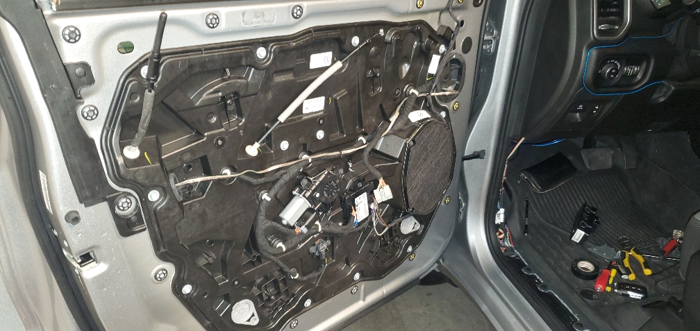

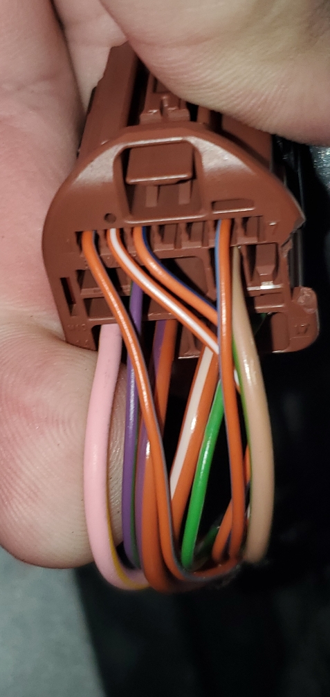

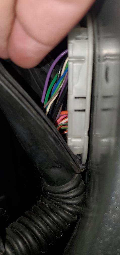

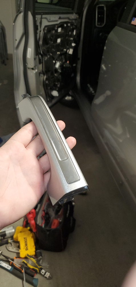

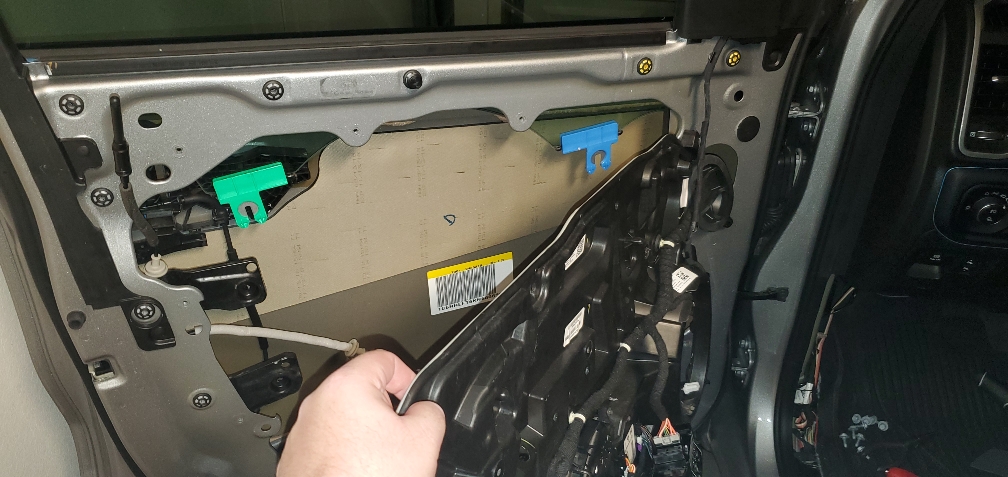

Got everything hooked up and ready for the sales code to be added and the handle and cap to be plugged in
Hopefully next week I'll have passive entry

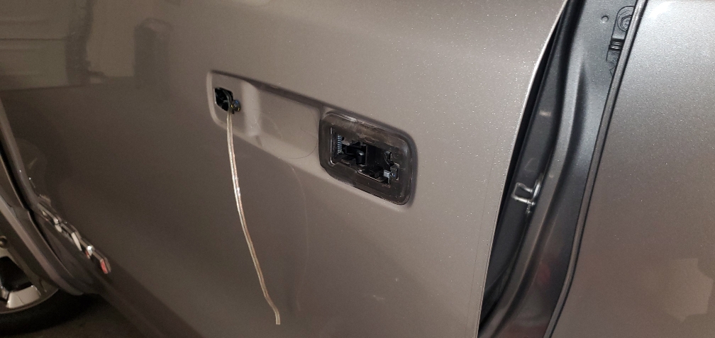

Is it all plug and play or do you have to run wires too?(whats that wire sticking out of your door handle opening?)
You can try to find the wiring harness and pay $130 for it or do what i did, i ran wires and tap into the original body harness.
The wire that sticks out from the handle is the sensor wire i ran from the body harness.
