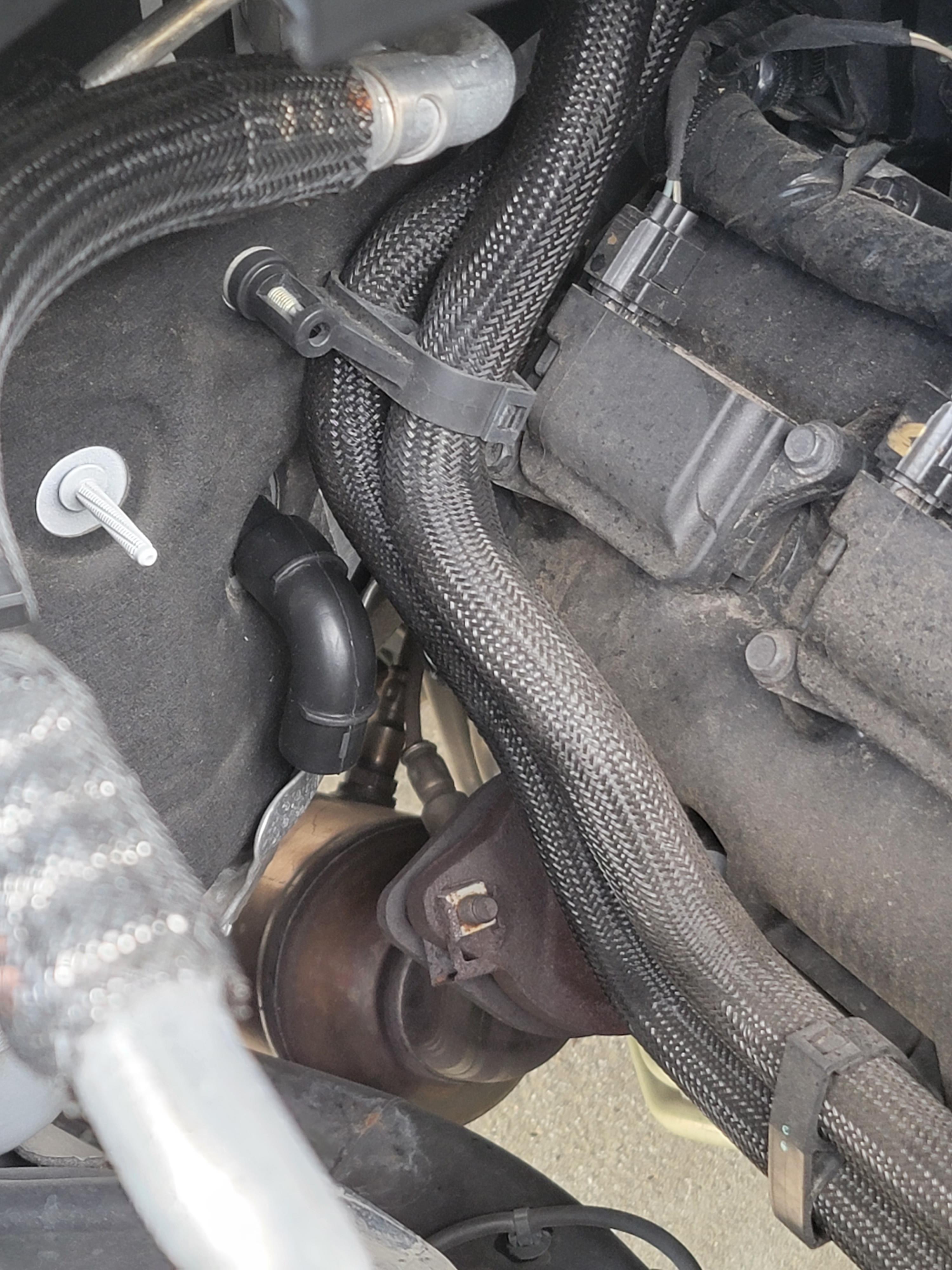

Mine wasn't leaking, but because of all the talk about it, I put this on there.
These are 5/8"
