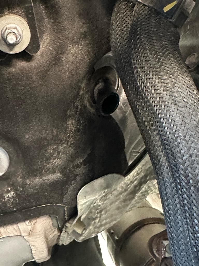

I did the simple $10 mod. Added the Dorman 46051 hard rubber elbow, 5/8 but had to cut a slit to get it to go over the AC drain tube. I couldn't get my calipers in there, but I'd swear it's closer to 3/4" then 5/8 OD. Also added a hard rubber down tube to below the frame so no water is running down the fire wall or can get on the cat/exhaust or in the frame. Over kill, I know, but why not!. It does appear on my 2024 that the stock tube sticks out a bit farther then other pictures I've seen and so maybe their catching up over there in Ram engineering. 20240626_191944.jpg20240626_194551.jpg20240626_174420.jpg

I did the simple $10 mod. Added the Dorman 46051 hard rubber elbow, 5/8 but had to cut a slit to get it to go over the AC drain tube. I couldn't get my calipers in there, but I'd swear it's closer to 3/4" then 5/8 OD. Also added a hard rubber down tube to below the frame so no water is running down the fire wall or can get on the cat/exhaust or in the frame. Over kill, I know, but why not!. It does appear on my 2024 that the stock tube sticks out a bit farther then other pictures I've seen and so maybe their catching up over there in Ram engineering. View attachment 185358View attachment 185359View attachment 185360

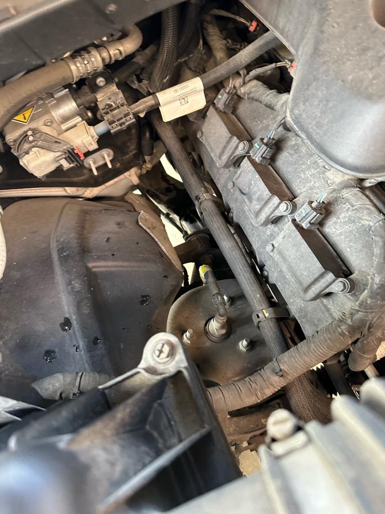

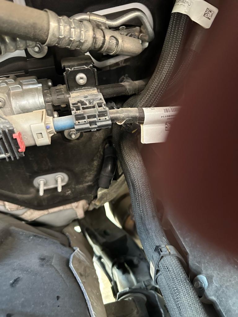

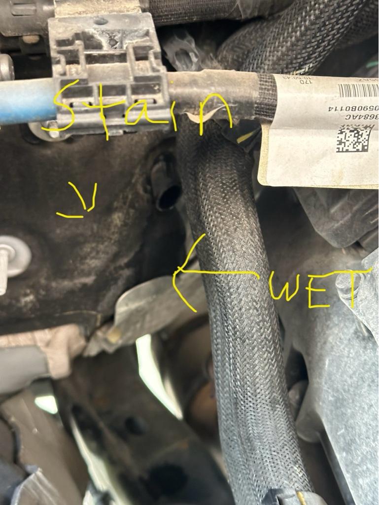

Hello, new to the site. 2021 Ram 1500 Air Conditioner drains into the front floorboard instead of through the firewall. 2400 miles on the truck. I can feel air coming out of drain and the occasional drip of water, but virtually all water is draining into the front passenger floorboard. With the truck idling and A/C on, I can watch the water rolling down from under the black rubber mat that goes up the firewall. Anybody hacked this problem on a new truck. Thanks.View attachment 107263View attachment 107264
There are two drains located on driver and passenger side of firewall. Those tend to get clogged up with debris preventing drainage.
