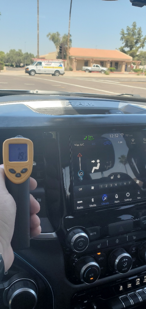

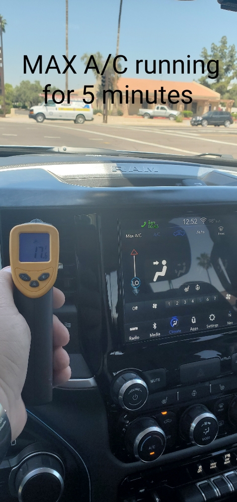

Something is very wrong either with your A/C system, or with your thermometer. Likely the latter. I don't think an auto AC system is even capable to produce such temps. And if it somehow does, this will likely damage or destroy something. This is not a normal situation or by any means and I don't think this whole discussion should be a "whose is cooler" contest ;-)
I don't think that having a 17F air blown on your sweating self is a good idea, either.

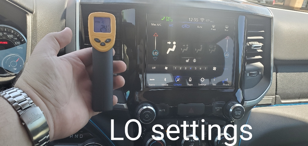

It is very cold and I sometimes turn the AC off because it's too cold haha

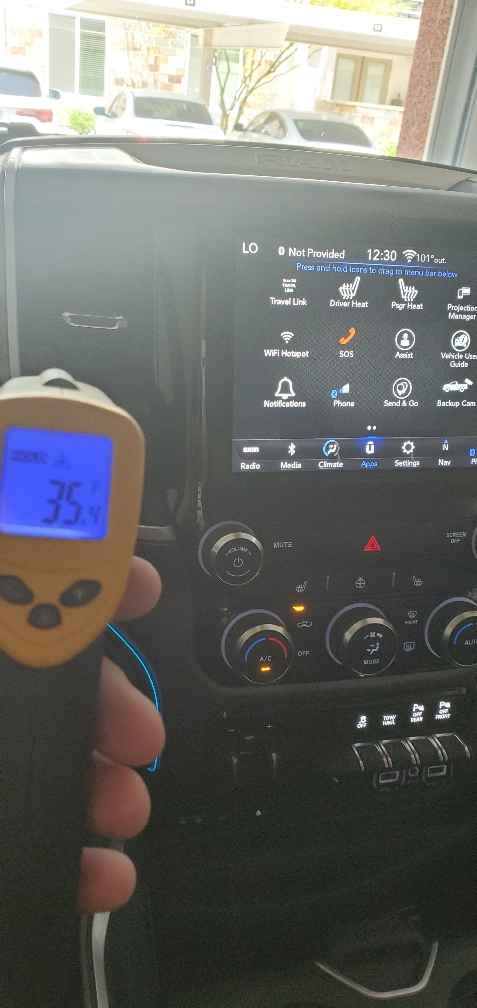

I just moved the gun and the temp changes, depending on where you point, I guess there was a piece of plastic inside that was very cold, when I move it it varies from 20F to 38F. Feels good to me.
15 degrees below freezing? Does not make sense. I would check that thermometer on an ice cube, then boiling water.

The readings were taken after 10 minutes of city driving.
It is 99F outside at the time of testing.
Will get to 103 so we'll see later... but it's pretty hot and the temperatures are low af...
That looks like the same $20 thermometer available on amazon. It claims to be +-2C accurate under 100C and covers -58F to 716F. A few customers mention poor accuracy.

It has 13,500 4.5 stars reviews... i think it's pretty good...
I will buy a different one today and check again.

If I stick the face of my temp gun directly on the vent I’ll get reading like that as well. I took my reading about 6-8 inches away from the vent. No hack.
