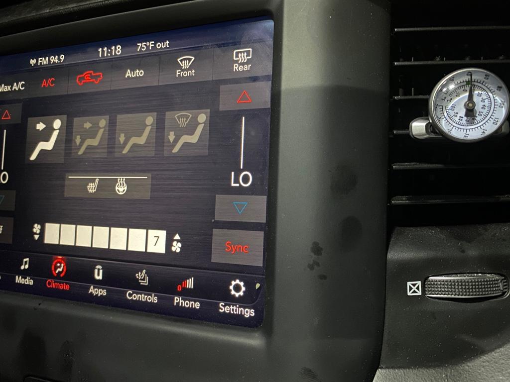

Look at post #29 in this thread. Outlines all of that for you.Do we know what the new gen Ram 1500 AC vent temp should be at max AC while idling?
I've seen that post. Are you sure that is at AC vent temp at idle and not highway speed?Look at post #29 in this thread. Outlines all of that for you.
I would assume those temps are what you should see at optimal conditions, so if going down the highway helps which it usually does that's when id expect to see the better temps. The less information they give us the less liable they are to fixing trucks that don't perform as they should.I've seen that post. Are you sure that is at AC vent temp at idle and not highway speed?
Very true. It's important to know the spec temps for each scenario (idle and highway) if we are going to accurately diagnose whether or not our ACs are performing properly.I would assume those temps are what you should see at optimal conditions, so if going down the highway helps which it usually does that's when id expect to see the better temps. The less information they give us the less liable they are to fixing trucks that don't perform as they should.
Post 29 doesn't specify idle, fan speed, or anything. You do realize they could set the rpm to 2k to emulate a driving condition, etc right? I'm not talking about pressure in the system and having gauges out. I'm asking do we know for sure that the vent temps in post 29 are, in fact, supposed to be the idle with engine warm temps...or are you just assuming that? It doesnt say on the little image either wayThis 'AC' issue is so beat to death on this forum it is CRAZY! if you search you can find the entire troubleshooting procedures that are followed and which the values (from post #29) are taken. the temps in the post are NOT highway speed LOL - that would be some fun troubleshooting to have gauges hooked up to the system and the tech hanging over the fender looking under the hood at 70mph LOL.
I found it already. Thanks for your work though...I think it's good to have this in multiple places. Also, no need to be a d!ck when people are just trying to ask questions--it really doesn't help any one and it's one reason that people stop frequenting forums.LOL, yes I realize that, so take a look at the service manual for yourself ....search is your friend ..... and she'll give you your answer ..... posted on this forum ..... the entire troubleshooting procedures (which the table is one part of ) - I was curious so just did it, took 2 seconds, good practice for you to search and empower yourself - go find the rest
Operate the HVAC system under the following conditions.
- Engine at 1,000 rpm at operating temperature
- Door and windows closed
- Transmission in PARK or NEUTRAL with parking brake set (depending on transmission application)
- A/C heater controls set to recirculation mode (MAX A/C), full cool, panel mode, high blower and with A/C compressor engaged. If the A/C compressor does not engage, see the A/C System Diagnosis table.
