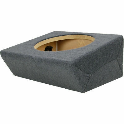

Does anyone know of a prefab single 10” sub enclosure that will fit under the rear passenger side seat and not go all the way across the entire rear seat? I have found plenty of dual 10” options, but not many single 10” options.
Something like this should fit a shallow 10 - not the prettiest but you could recarpet or repaint it:
Thanks for the recommendation! That box would fit perfectly under the rear seat, but the calculated sealed volume would be a little small for the TW3 sub I’ve already bought. I’m currently working with Sound Off Audio in developing a 10” sub enclosure ~ 0.5 cu ft that should fit perfectly under rear passenger seat even with all weather mats. I’ll post it here when it’s finished in case anyone is looking for the same enclosure.
Crew or Quad Cab?
I'm looking to get one fabbed up for my QC
