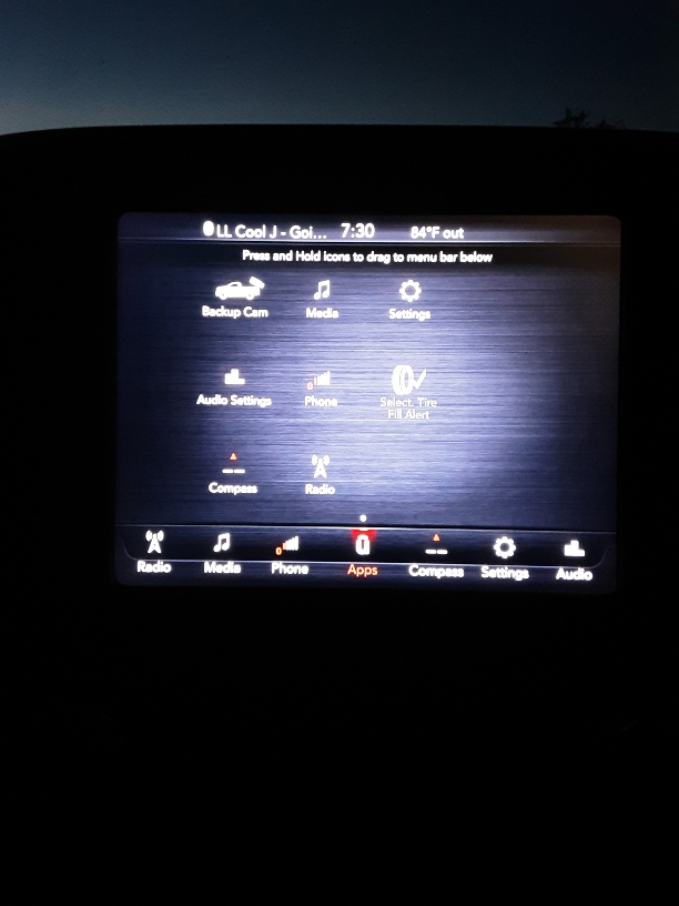

So I got everything I need to do the 8.4 inch upgrade on my tradesman. Got it all put together and hooked up all cables. Powered it all up and got a screen and menu that shows I have automatic climate control and touch screen features to control it. Way different than im used to. Tried using Android auto and nothing. AA never showed up. Figured I did something wrong. Disconnected everything and reconnected. Now I have the display I am familiar with. The one I had on my 19 Big Horn with this system. So it looks good but still no Android auto. Using A phone I've used with my previous truck so I know it's not the problem. Used two different USB cables and nothing. I don't get the AA icon nor the mirror icon under Uapps. I let the truck sit powered on for a while and still nothing. I thought it takes a while for evening to start up... mine immediately powered up with everything accessible except AA. Any ideas?
Sent from my SM-P610 using Tapatalk
I think it could be my USB cables. I noticed my phone is charging but uconnect never recognized the cable. This past week with my 5 inch uconnect I noticed when I used BT connection then plugged up my USB cable it didn't recognize it either. Normally after I connect it the unit will stop playback and prompt me to select a source. I'll pick a new one up tmrw and see how that goes.
