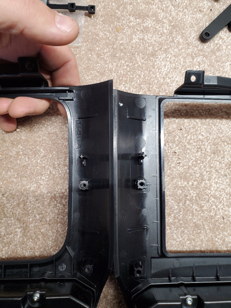

On another note, here’s why the center dash can’t be reused. The radio bezel locating tabs and mounts are different. This is from member kristof-
Yeap there is no way to do it. I even cut off the locating pins and removed that little tab on the side of the screw post (you can see it on the photo above on the right side) .
Here is another photo for comparison.
