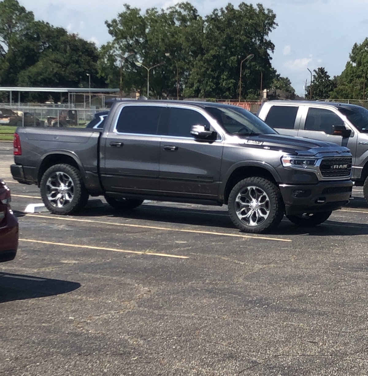

Finished
Revell Links with Daystar spacer and the Mopar 2in UCA installed with Nitto 285/55/22. It ride just is good as stock. There is a slight bounce just depends on the road but it hardly noticeable. No tire noise at all very happy with the results. Picture taken is in normal mode all level function works truck goes into aero mode as before.

I'm guessing people are just measuring the new distance for the links?
