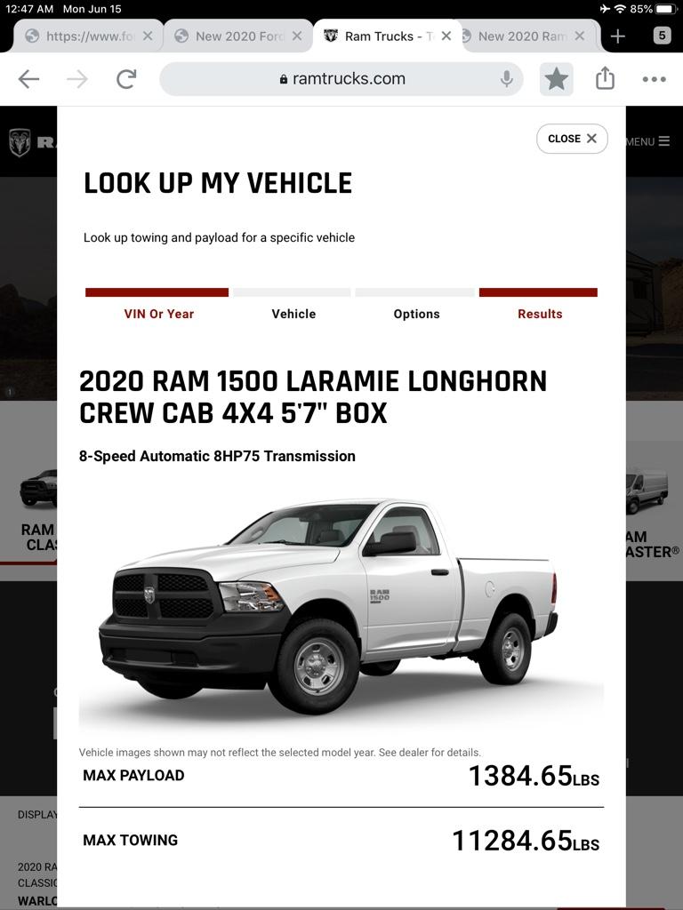

I found a longhorn air 3.92 crew sb and took then vin into rams towing section and got this response.
It's lower than you want. https://www.colonialdodgechryslerje...chusetts-8a2157240a0e0a6b43a3789ba47ce659.htm
That's kind of what I'm afraid of. Not sure if the longhorns are heavier than a "regular" laramie but that payload isn't much better than my current RAM. Defeats most of my reason for getting a new truck.

You have to use a VIN in the configurator to get the accurate number.
If you just use a trim and a configuration...it will be wrong and list it as it is a tradesman.
Hope that makes sense.
Without a VIN you are just getting the towing chart number.
With a VIN you are getting the configuration with the options that make it a Limited.
Very few people have a truck that will be 1700 in payload...you will not get that with a limited. Need a tradesman or lightly optioned Bighorn.
