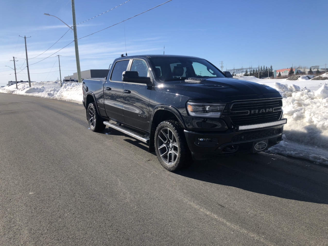

3.5 lift not a good idea
This is probably due to the spacers used and the stiffer shocks that come on the off-road package. They use an “HD shock” which translates to stiffer ride, couple that with a poor lift and it’ll ride like garbage.

I have the orp with the ready lift top hat spacer. We did not use the pre load spacer since readylift did not recommend it with the orp. The ride before tires was just as good as stock. The E series tires stiffened it up some but still rides great.
Those cv angles are sharp. I would be very leary of putting it in 4wd like that.
I would go with a 2" or 2.5" top hat spacer in the front. That will essentially make you identical to a 3.5" kit on a non offroad package truck. Then add a small spacer in the back if you still wanted some rake. The 3.5" kits are not intended for Rebels or Offroad Package trucks because of the 1" already from the factory. You could always just pull out the preload spacer and then it would essentially be a 2" lift all the way around instead of having to buy new tophats. You will still have rake this way though, unless you remove the rear spacer.

CV joints operate within an optimal range of travel. Extend the travel too far and it over-stresses the structural integrity of the assembly. When in 4wd, the drivetrain is applying pressure on the joints which could potentially cause failure. With the sharp angle that his CV joints currently have on flat ground, any downward movement (off-road, large bumps, etc.) will exacerbate the situation and hasten potential failure.

So is this something I would need to worry about if I did leveling spacers? I'm considering 3inhes in front and 2 in back, but don't want to compromise the trucks integrity

I personally went with the 2.5” ReadyLift with Upper Control Arms on both of my 19 Ram 4x4’s. Many are going with the 3.5”, but the concern comes in if you have an OffRoad package truck. It already takes 1” of travel from the original design configuration. If you add a 3” lift to an OR package truck, you will be very close to the CV limits. It’s entirely your call, just sharing my opinions (which are like navels...everyone has one). :)

I do NOT have off-road package. So would you think the 3inch in front and 2 in rear is too much?

You’ll find many that have the 3.5” in this forum with no issues, so I wouldn’t think you’d have an issue with the CVs at that the 3” height, but the Upper Control Arms will be significantly extended which could lead to ball joint failure down the road. You’ll probably want to invest in either MOPAR or ReadyLift upper control arms if you go to 3” rise in the front.
I have the off Road package that’s Why i do ont put the top spacer (ready lift 3.5)

So putting the 3.5 lift on a truck that doesn't have the ORP will be fine ?
