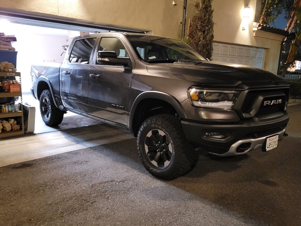

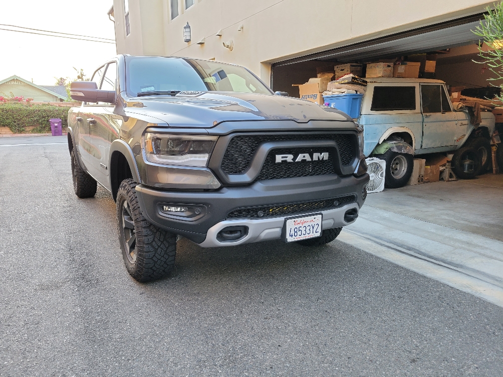

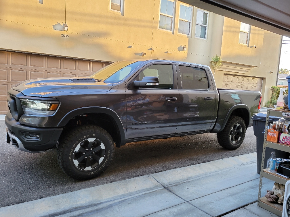

Wanted to share some photos of my recent lift. I did the Fox 2.5 DSC coilover set to 3” however I think it netted me a few more mm’s than 3” as it looks higher than my Mopar + ORP lift. I foolishly didn’t take measurements - was too excited to get them on haha. Install was super easy, I have a lift at my place and have done several rams now, including my own. But to not have to mess with springs compressors is awesome lol. They came with a little bracket to mount the canisters which I thought was super cool. Shows off the canisters very nicely.
I went with a readylift SST upper control arm after seeing the BDS failures. The angles seem good. The ride is absolutely phenomenal, which I expected to be for the money. Not the cheapest but the quality is definitely great. Sorry for the dirty truck.
Nice looking truck. how are the front cv axle and ball joint angles on this lift. does it needs anything at the rear except 2" coil spring spacers?
CV's are fine, ball joint angles are good as i used 3.5" readylift arms.
