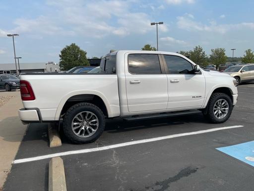

Non-lifted, non-leveled Ram with 285/60/20 Ridge Grapplers. Slight rub on full lock turns, but not enough to bother me.

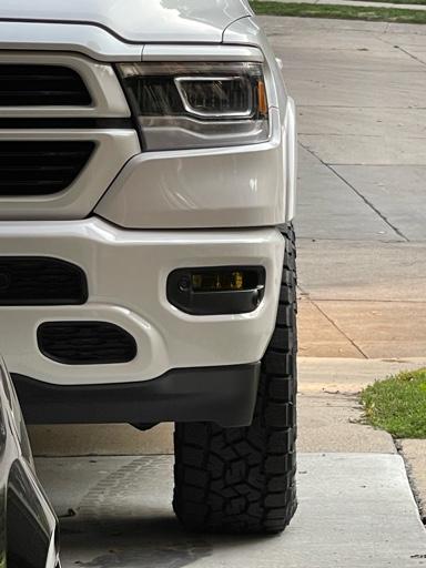

I went from 285/60R20 on stock suspension, no air ride, with same slight rubbing at nearly full lock. Just put the 5100 adjustable shocks in the front and raised it 1.75". Now no rubbing at all on full lock and when going up/down curb (driveway). Recently went out to the Sand Dunes and had no issues during articulation events :)
May go with 295's on my next go around and hopefully no rubbing at all still.

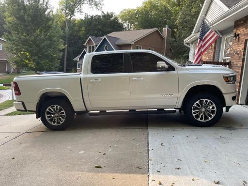

First time poster, 2 week lurker. This is my 2019 Ram 1500 Laramie 2WD. Just installed the Rough Country 2" leveling kit and some 295/60r20 Nitto's. Its in getting an alignment now, but the drive over was smooth, running currently at 41 PSI. I am thinking that is low since they are max rated at 80psi. Looking at Nitto's website for more info. Anyway, I am loving the look and thought I would share with the rest.

Do you have any pics down the side of the truck? Would like to see if they sit flush with the fenders? Also are you happy with the ride with the bigger tire?
295/60/20 ridge grapplers 2” rough country level

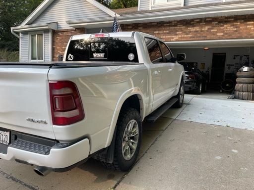

Looks good; I have my 2" front and the rear +1" ORP springs in, the 295/60R20 are being mounted friday with a fresh alignment. I have the factory rubber mudflaps.. hope it clears.
295/60R20 Toyo AT3 with 2”level and 1” ORP rear springs.
Front barely rubs the OEM Mopar flaps. -----*****************Corrected by just bending the support brackets on the flaps
