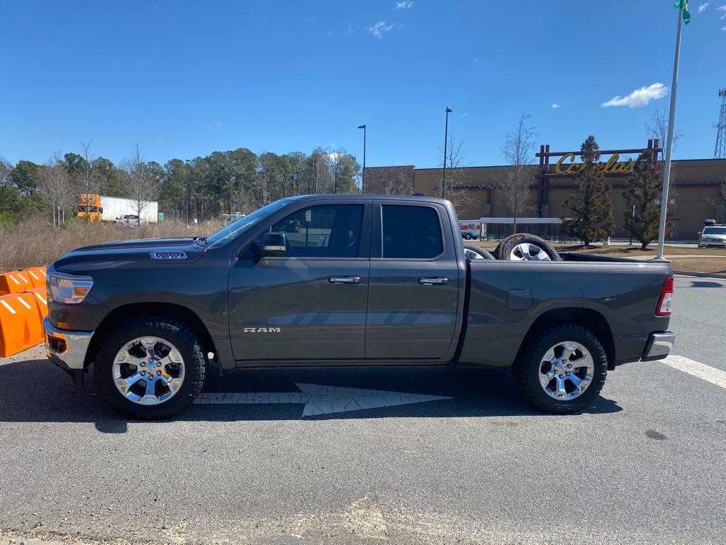

285/65R20 Stock Wheels 2 in level
No issues, no rubbing or trimming
No Air Suspension/ No Off Road Pkg.

Great looking truck! I’m looking to do your exact setup soon with the 2” motofab and KO2s. Would you make any changes hindsight or are you really happy with this setup?
Thanks im really happy with this setup no issues but maybe later on im going to add/switch another upper control arms just for safety.
Yea that was my next question if you did anything with the UCAs. Thanks, good to know.
