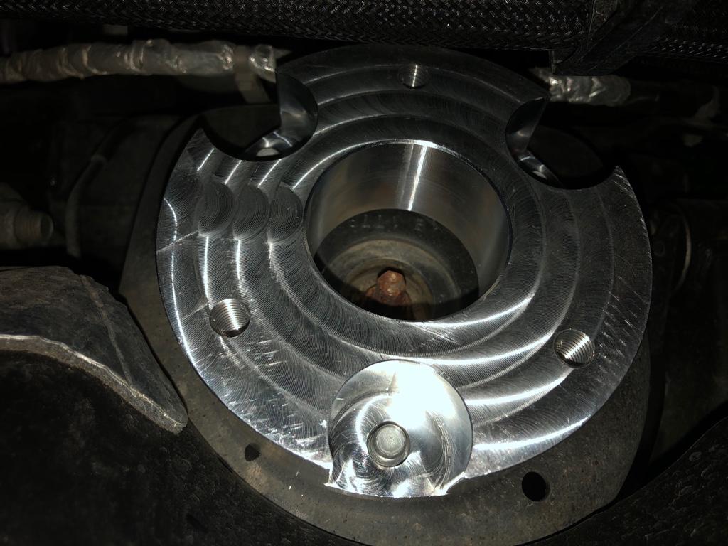

43
These are from eBay, made in USA. My front fender lip went from 36” to 38”. Rears stayed same at 39”. I prefer a slight take, both aesthetically and for towing. Helps my air bags be able to keep the truck level. Fitment and directions were great. I’ve done these before, so nothing new here. I have to get an alignment eventually. I checked toe and camber with my tools, and they are very very close.
Had issues in past with 2.5”s giving 4wd CV vibrations. So hopefully don’t get that. Also hopefully the upper balljoints stay happy for a bit. I really didn’t want to change all that crap. I’ve some 6” kits on 4th gens, and the front diff brackets are hell. And the custom tie rods required to fit the drop knuckles are junk and get loose at 10k. I’ll be happy with some 275-60 or 65s in the future.

Not really..you remove tie rod and sway bar nuts, then I Reference marked and removed lower control arm to frame bolts, let it fall, and remove the strut to install spacer.

So its only been a day. Really nothing negative to report here. The ride is unchanged, didn't really notice anything different. I marked the control arm adjustment cams, and just put them back. Checked toe in with a tape measure, and its still about 1/8" toe in, which was what I noted before I started. *I know this is not proper measurement or alignment. I will get an proper alignment at some point. But it really didn't throw anything totally out of whack. I probably also need to adjust my headlights. The factory LED's are bright, but I've never had anyone flash me back until last night. So they may be up a bit to high. I should have measured before I started. No odd noises, creaks, clunks, or excessive harshness. Maybe slight slight slight firmer. Might be my imagination.

For what its worth, I purchased the 1.5" version. Without trimming the factory upper mount studs, this is the shortest you can go,,else, I would have gotten an 1" version.
That being said, I received about 2" of lift with them. My front fender lip went from 36" to 38". Maybe it will settle in a few days, dunno...But I'm happy.

I have a 4x2 Laramie w/flares and measured mine from the ground to fender flare lip being 36" on front & 38-7/16" in the rear in stock form. I ordered the 2" version of what you ordered, thinking I would end up with about a 7/16" rake. The photo below is from the ad that I purchased from and how to measure what you need.
Another note....the ad is listed as 2006-2018 Ram 4WD, so I can assume the ad is wrong and it also fits 2006-2020 as well. Also, I have read where there should be no differences in the front struts between 2WD to 4WD. Can anyone confirm all of this? Spacers are already on the way, so I put the cart in front of the horse, but if it doesn't work, I'm only out about 30 bucks. Just be nice to know this is going to work before I get things torn down and run into unforeseen issues. TIA.

Fit verified, thickness of spacer on 2” kit is 1.350”. Will be installing soon.
Installed yesterday, was a b!tch by myself, but got it done. VERY pleased with the result, perfectly level within a 1/16.
38-1/4" front & rear + or - a 1/6"...when I measured above, I don't recall the fuel I had. I have a light load in the bed right now (maybe 75 pounds) and 3/4 tank of fuel.
