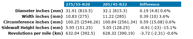

I may have found a set of new 22” limited rims. They are factory balanced and 285/45R22. Can they be mounted on the limited with out additional balancing and with out any clearance issues when turning?

The circumference difference is around 5/8”. Would the wheel bearing difference matter?
The wheel bearing won’t make a difference. People are routinely putting 35” mud tires on the smaller wheel bearing trucks with no issue and those are much heavier than the stock 22s. The speedometer may be off a bit but since you are sticking to the OEM 285-45-22 tires the dealer will be able to recalibrate it for you

Thank you Warmachine. I looked up the speedometer difference on a web site. It said +0.38 at 65mph so 65.38mph
