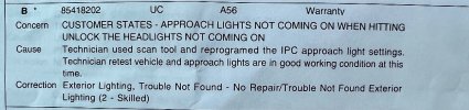

APPROACH LIGHTING: Dealer says fixed. Also says, headlights coming on is dependent on ambient lighting (I assume not street lighting but sunshine). Tested SAT in the garage repeatedly. Hopefully the below will help someone. They said they used the manual for the reprogram.IMG_9161.jpeg

I still don't think the Proximity Wake-up and Headlight Animation work properly on my Tungsten. If I unlock with FOB, the headlight animation works. But if I just walk up to the truck with the FOB in my pocket, nothing happens. I have all the options turned on, with time settings other than 0. I left the truck locked, and walked into the store (or work or wherever), and then later approach the truck. Never get anything to happen unless I press the unlock button on the FOB. Am I missing something?
