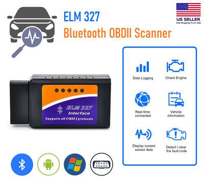

I use the free "Torque lite" app and dongle similar to this.
Found it! Cheap, but it works. Have had it for years...
I mean, a $12 OBD scan tool will check and clear codes just as good as a $100 one. Mostly depends on the app you are using.
