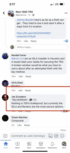

Here's what was said about the Tazer on the TRX forum (by the IGLA guy).If you set a pin with the Tazer, what happens if you unplug it?

In my opinion putting a Tazer on your truck as a security device is like rubbing hand sanitizer on your junk, then banging a lot lizard from a truck stop and expecting it to protect you from getting herpes. Just saying. IGLA is your answer.
I guess for people who have never used the TazerDT security functions, sure. Not a single post in that thread mentioned anything about HOW the TazerDT could be defeated.After reading hundreds of posts about security devices for Ram trucks, this post sums up the use of a Tazer as a anti-threft device the best.![]()
