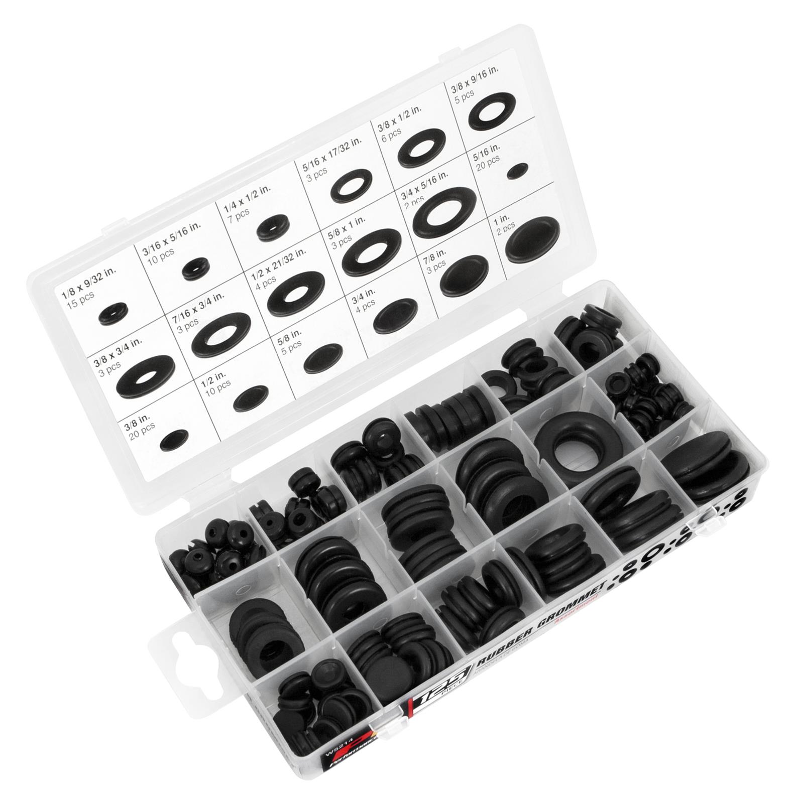

I just removed one on the driver side and replaced it with a rubber grommet, good way to run my antenna cable into the cab.
It was glued on for real BTW.

Where did you get the rubber plug? Is it round or the 30mm x 50mm oval plug?
Performance tool W5214 grommet kit. Had it on hand from my days of working on my `62 Austin Healey Sprite.
I used the 1" round grommet, it conformed well to the oval hole.
edit: Wait, did you say 50mm? This might not fit then.
edit2: sorry this will not fit.
