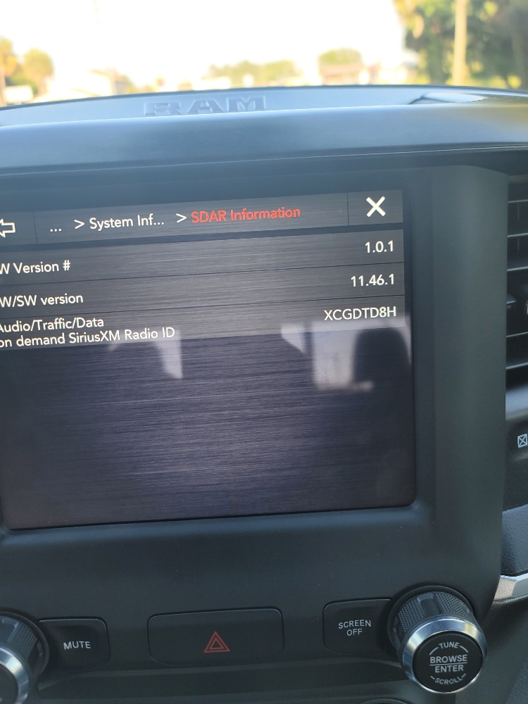

When phone is connected and or after getting a notification radio volume gets distored if i unplugged usb cord from the phone radio goes back to normal, i noticed the firmware still at 11
