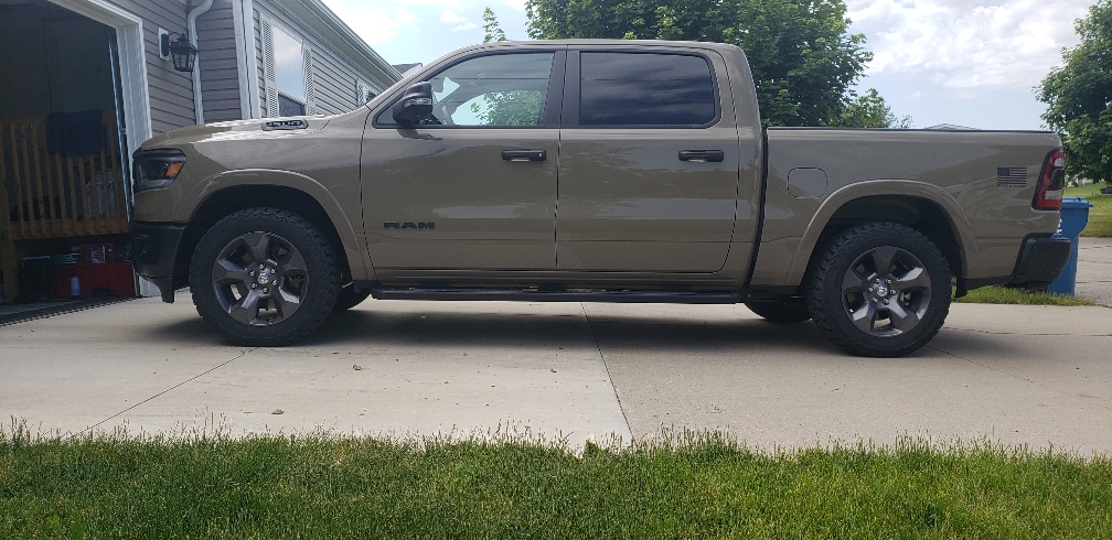

2020 Ram 1500 Built-to-serve Big Horn on 35" Ridge Grapplers tires with RC 2" level

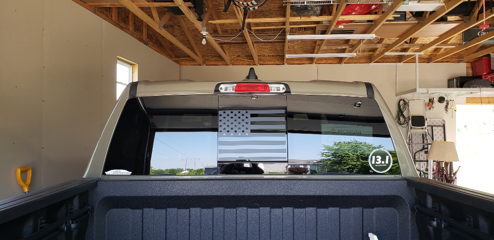

Beautiful truck, congratulations. Like me, you got both Ram Boxes and MFT (Multi-Function Tailgate) - did you also get BUG (Bed Utility Group) so you got the cargo divider? I am incredibly happy with the 1-2-3 combination of Ram Boxes + MFT + Cargo Divider.
Good luck with your new rig.
BTW, you might be interested in this flag decal:
https://www.amazon.com/Elevated-Auto-Styling-Middle-American/dp/B07QX2LDVQ/ref=sr_1_2
Flag doesn't have enough stars if that bothers you.
Nice, I’m looking some pictures with this configuration. BTS 2 inch and 35
33.4 in tires work good also with no lift and no rubbing.
Of course, I'd prefer it be 100% correct, but only about one in a hundred will notice that, so to me it's not a biggie. I like the look, and 99/100 people that see it just see a regular US flag, which is what I'm after.
I have it on mine, only had one person say anything. Only one I saw that would fit and be correct did not look as good.
Ive been trying to find these wheels. Mine are chrome but want grey or gun metal like these. Anyway you can direct me on how to find?
That sure does look really good. Those 35s on 20” wheels are perfect.
I’m curious if you have any pics to show how close the tire gets to the plastic when you turn the wheel. I have 2” spacers right now, and I’m guessing I’d have to remove them for 35s.
Did you ever get your speedometer recalibrated? I know nobody goes 35s for mpg, but I’m curious where you’re at. I’m at 15.3mpg with 33s already, so a bit nervous where I’ll be with 3.21 gears and 35s. I’m also close to pulling the trigger.
I was thinking bout installing the RC 2'' spacers myself, how have you made out with the spacers, any ball joint troubles ? or bad ride quality?
None. I have over 15k miles with them installed and everything has been good.
Just thought I would share some pics of my new 2020 Ram Built-to-serve edition with a 2" RC level kit, 35" Nitto Ridge Grapplers (295/65r20) on factory wheels, with no rubbing. The best kicker is that I have 3.21 gears. Can't really feel a difference in power. Don't know if the etorque has anything to do with it.

Are you running any wheell spacers in these pictures. Nice truck
Ordered my 295/65’s today
Did you have to do the level kit to clear the 35's or did you just prefer the leveled look?
Bought my wife a grey built to serve and I'm thinking about installing some 35x12.5 Nitto Terra Grappler G2's but I'm reading mixed info on if it'll clear stock height.
The 35x12.50s will rub without spacers. I'm having 35x11.50x20s with stock wheels put on my 2020 Bighorn this Thursday with a 2" level, but I'm going with Toyo OC AT3s this go around. I've had wear issues in the past with Terra Grappler G2s and I hate the sidewalls on them - too plain for me. I'll post pictures of before and after once it's done.
I was told that anything over a 1" level I would need new upper control arms. I see you didn't change. Does anyone know if this is true or will it wear down the ball joint eventually? I'm also looking to put 285/65/20's on.
Incorrect. Anything over 2" level and you need new upper control arms. I just put 35x11.50x20 Toyo OC AT3s on my 2020 Bighorn. Pictures over on the 34"/35" thread. I have the Readylift 2" level on it. Runs smooth. I will say I looked at putting 285/65/20s on my truck, however the shop I did the work with told me that the P-Metric size tires from most of the major OEM tire manufacturers are around $40-60 over the standard sizes like the 35x11.50s. The difference on mine was $55.00/each. When I considered the cost difference that paid for just over half the leveling kit and install.
I have the factory ORP 1" lift with the Built To Serve, so wouldn't that be a 3 inch lift total if I do the 2" ready lift?
I guess so.....you'd probably want to replace the upper control arms.
