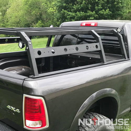

@Tex_Ram have you seen the roof rack/tonneau cover set up from Nuthouse? Think this is exactly what you are looking for. They will fabricate to the height you want as well. I found them and interested in going this route due to them having a similar solution for my ram box set up. You are far ahead of me on build, but it appears we are going similar directions.
