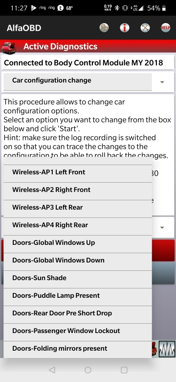

Did you enable global down in bcm or was there other options to enable to make it work? Door module setting? I was trying on my 19 with alfaobd, got other things working, no global down.Yes you can activate such feature, i have 2019 Ram 1500 Classic and used the alfaobd, obdlink bluetooth and bypass harness was able enable drl, change tire size, global window down, program 7" evic with miles, idle and driving hours

With alfaobd under global downDid you enable global down in bcm or was there other options to enable to make it work? Door module setting? I was trying on my 19 with alfaobd, got other things working, no global down.
how about global up?
Here is a pic of menuDid you enable global down in bcm or was there other options to enable to make it work? Door module setting? I was trying on my 19 with alfaobd, got other things working, no global down.
