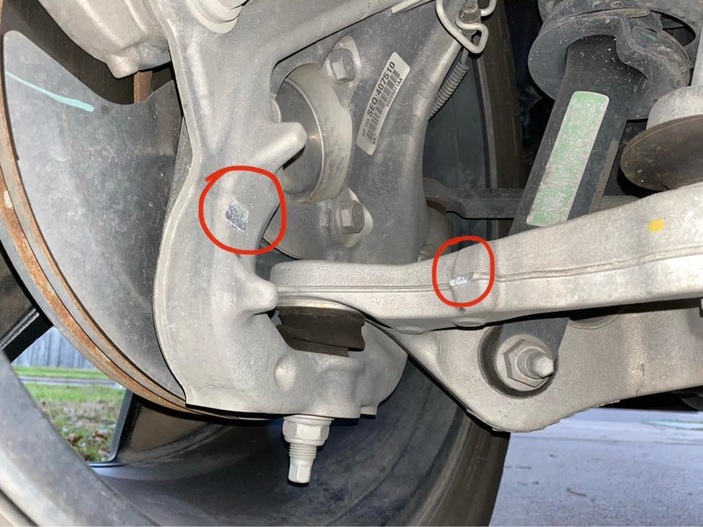

@ 20k miles it started making this grinding noise (like something is rubbing) when making sharp right turns. Now @ 23k miles and it’s making that same noise. You can see in the picture it looks like the the lower control arm is making contact with the steering knuckle(correct me if I’m wrong).

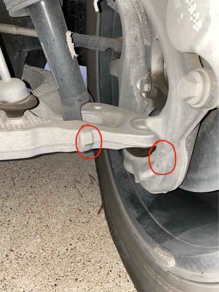

Same issue here..both side...2020 Ram Bighorn only has 1200 miles....

Wow only 1200 miles. Do you also hear the noise when turning left or only right? Let me know if you take it to the dealer.

Definitely taking it in. No reason is should be doing that. I only get the popping noise when turning right, as I’m going over a bump. Never really hear the grinding.

I contact fca and they said its normal when my truck its to much

I experienced a grinding noise as well and it was caused by the tires making contact with the plastic wheel housing cover when turning the wheels. When the dealer applied the underbody rust protection the hot grease melted the plastic wheel well and twisted it out of position. The dealer replaced the covers and the noise went away.
