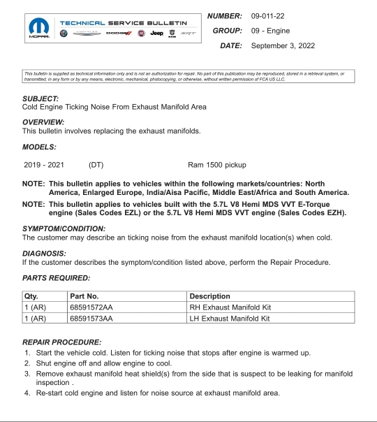

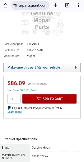

Here's the TSB showing the AA part, and it being superceded by the AB if you go to order it.
