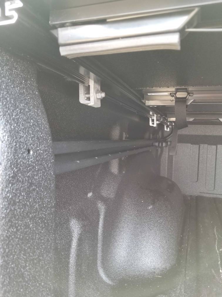

Can I ask where is the clamps actually clamp onto the truck? Can u show me a picture? Need to see if I have to uninstall the ram rail to install this cover. Thank you.
Sure. I will post a picture later. Once you put the rail in place, it automatically likes up with the side rail in the bed to clamp.
