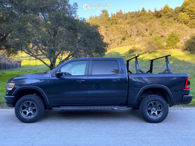

Thought that I’d share because I definitely know the struggle… I have a 2022 Rebel with 18x9 fuel shok with a -12 offset on 295/70/18 cooper evolution tires (34.3”x11.6”) I have a 2” rough county level in the front and absolutely no rubbing. I’m happy with the look. I’ll update the pictures once it stops raining in Seattle and I can clean it up.
Looks great, could I get a part number for that wheel? I have a set ordered by I'm concerned about the backspacing. Thanks
