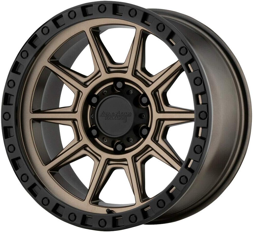

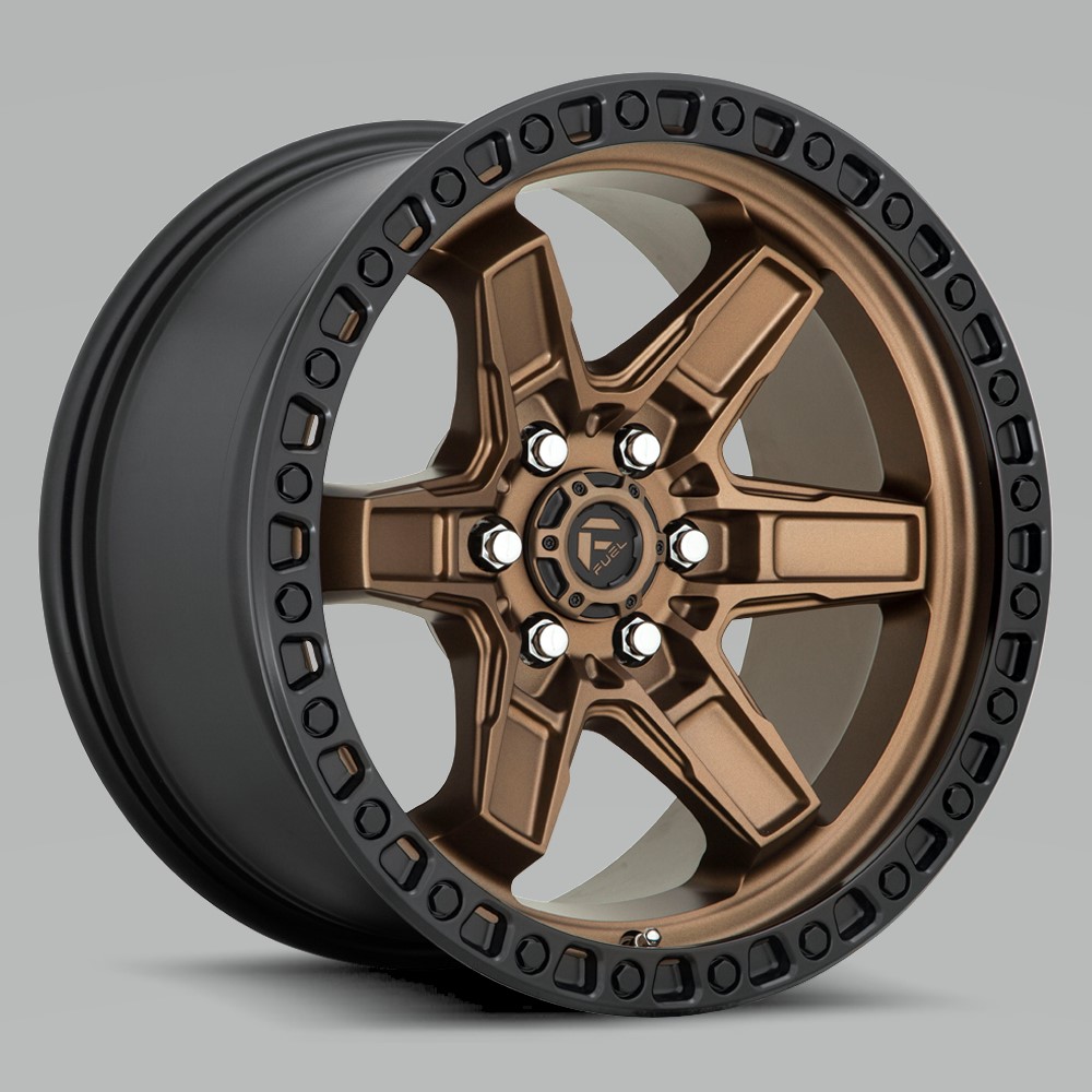

I bought a SST 3.5 kit for my 2020 Big Horn 4x4 a few weeks ago, and looking to order some Bilstein 5100s and 5160s soon, but once I get that all mounted up, I want to do an 18" wheel as well. I want bronze, was going to do the Fuel Shoks since other members have that set up, but these American Racing AR202s caught my eye...
https://images-na.ssl-images-amazon.com/images/I/61zYUu34qhL._AC_SL1000_.jpg
Was wondering if anyone heard if these fit or not? I see pics of them on 4th gen Rams, but not any on the 5th gens...
