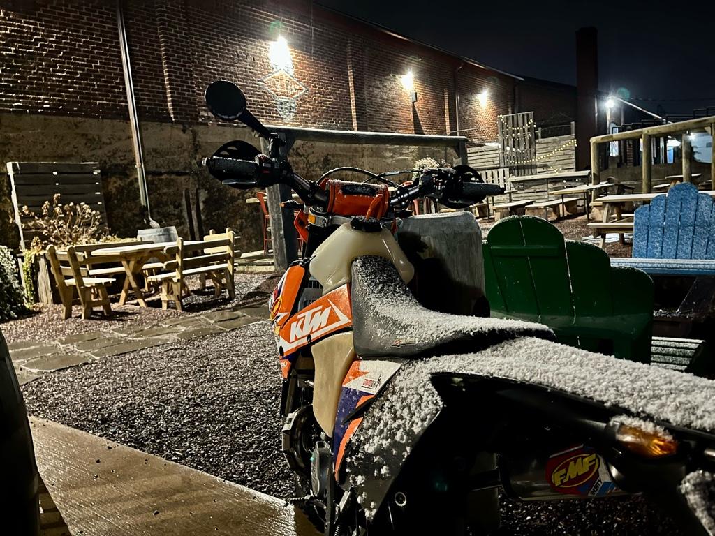

Yep. I still see a similar mindset with the 2 stroke dirt bike crowd. They are hopelessly stuck in the 70's.
Yep, otherwise she'll seize up.
It’s cold. So I switched to 1:1
