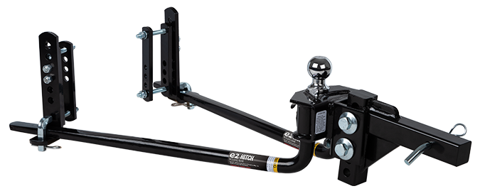

I also have towing group and pano sunroof. 5.7 bed, level 1 group, night edition group, anti spin axle. That’s all I have. Thanks and good to know that <30 would be good. Any suggestions for the WDH?
Thanks. That's exactly we are looking for. We need the bunks for sure. How is the quailty of your 2021 keystone? Do you use any WDH and sway bar for towing? I had the air suspension, but I believe the WDH is still an essential. Not sure about the sway bar, since the truck come with sway control right?
You have to use the WDH anytime your tongue weight is over the truck hitch rating. Most hard side TTs will be above that threshhold. Almost all hitch makers have sway controls available as well. It is a physical addition to the hitch setup. It's job is to reduce sway from the hitch to a comfortable level during "regular" driving. The trucks electronic sway control is an "emergency" control, similar to stability control. Do you rely on stability control in regular driving? Wait, don't answer that! ;)
I recommend the Equalizer 4-point sway

Thanks for your input. That’s so helpful. Where to know the truck hitch rating? I assume all 1500 series has the same rating regardless the truck brand? What is the rating with or w/o the WHD? Are they the same?
