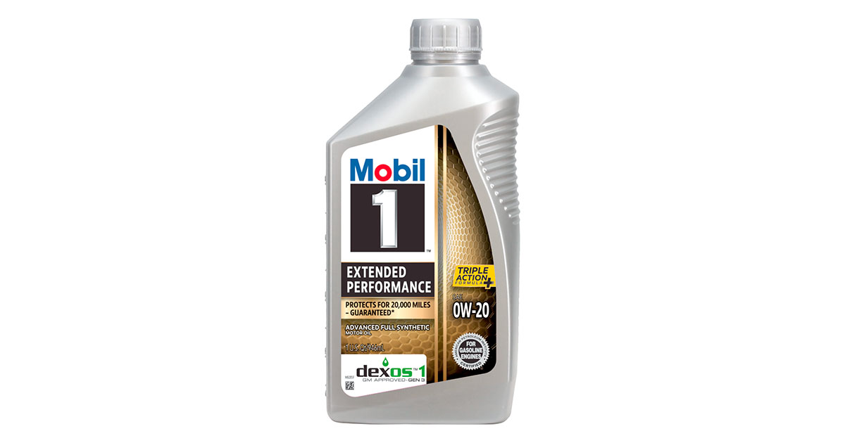

Mobil 1 full synthetic extended performance 0w-20 is rated for 10,000 miles. Can you provide some documentation/studies that 0w-20 breaks down quicker than 5w-20?????
Actually M1 EP states it can provide protection for up to 20,000 miles, but I get your point. Probably the best off the shelf 20 grade oil available.
