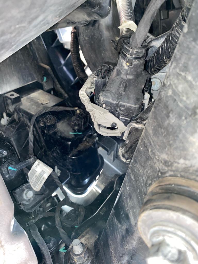

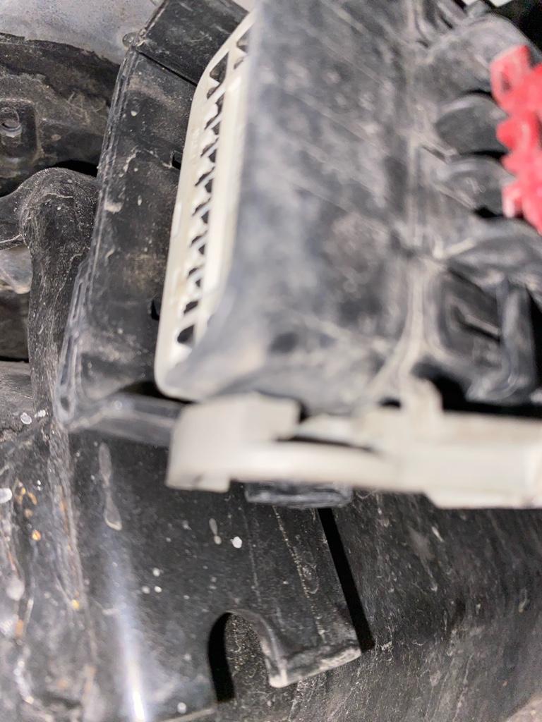

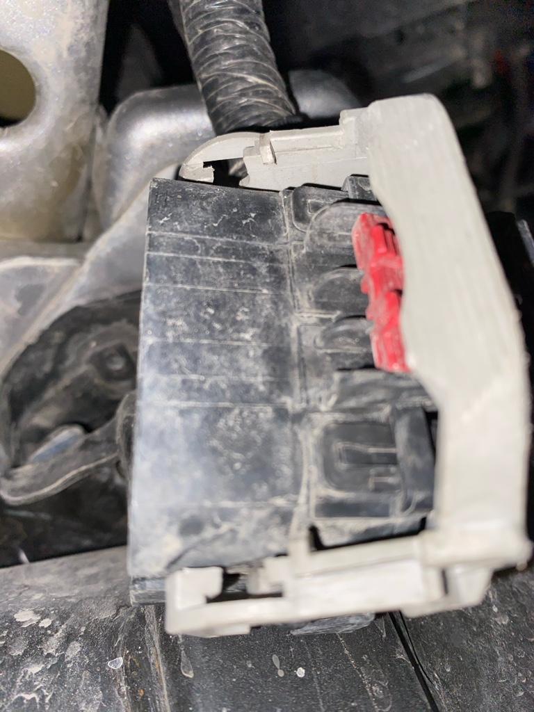

Hey guys I’m not that mechanically smart but I found that my fog lights wouldn’t turn on for my 2019 ram Rebel, I took a look under after replacing the bulbs and there is this wired that it just there and not connected to anything ( looks like a big clip) picture is attached please help me out

What kind of fog lights do you have? I ask because that doesn't look like the fog light connector...unless maybe they're HID/factory LED fog lights...
They are factory LED fog lights that come on the Rebel, when I turn them on the light comes on in the dash but they don’t turn on
Usually if there's a connection issue...there would be a light-out indicator. Like Of3 said...a pic would help.
That plug shouldn't be flopping around like that exposed to the elements. It must plug in somewhere around that location
Can’t find a place for it to connect at all
That means at least one of the lights is connected. Bad bulbs..?
Replaced completely, I think it must be that connector but I have no clue what it is and where it goes

Did the fogs EVER work? If you have front park sense, that wouldn’t be working, either. The front facia harness is either missing, or the connector for it came unplugged, and can’t be too far away-
I don’t have parking sensors on my truck, does that mean this is just an extra connector?
And yes, your pictured unplugged connector is definitely for the fogs
What I don’t understand is I can’t find where it plugs into , any idea?
No. That IS the connector for the fog lights harness (and park sense of equipped).
So I just run off the diagram right?
Did your fogs EVER work? Are there connectors plugged into them right now? If so, follow the wires to the driver side and they will come to the missing connector.
I’ll check right now and keep you updated
I just spent 10 minutes under my truck and can’t find the connector, the wire is there but no connector in sight
