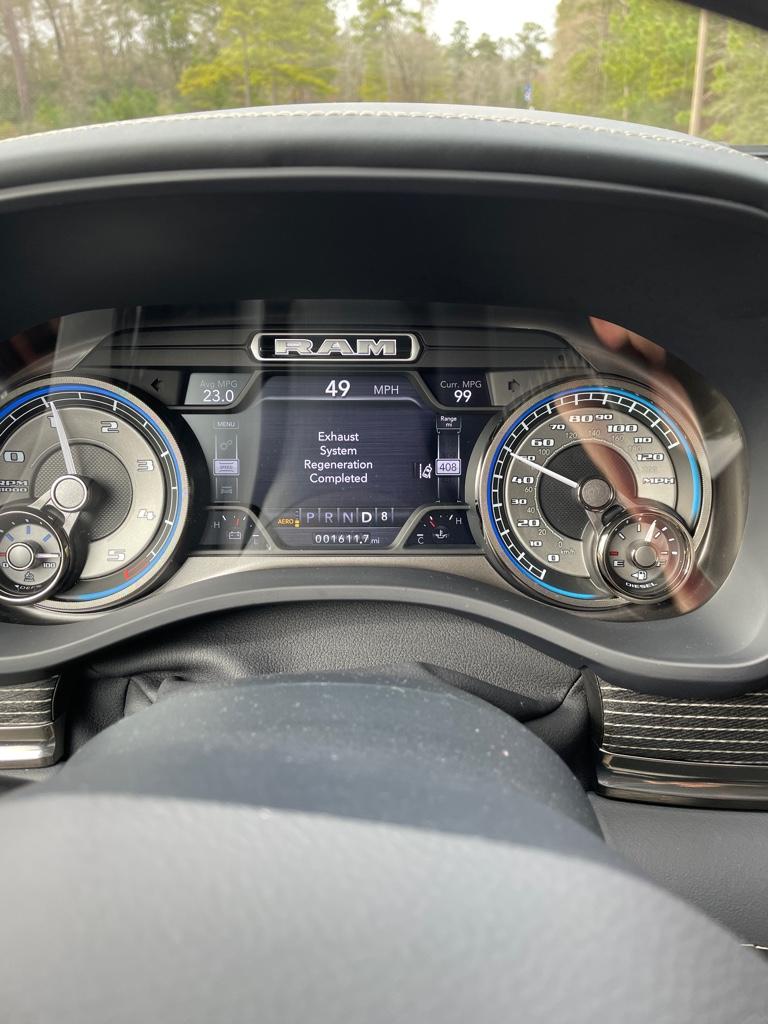

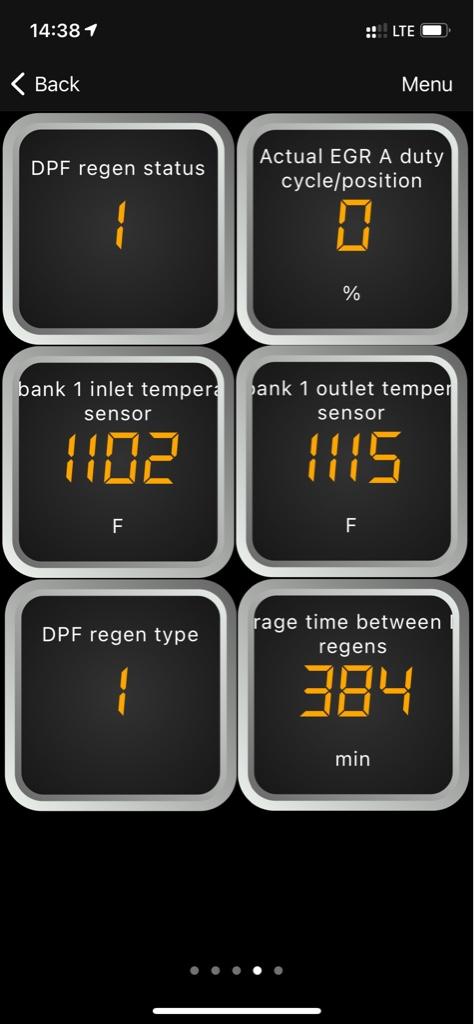

I got another message today:
I was not going to make to highway in less then 10 min so as you can see in picture above I did a gear limit trick to keep my rpms high.
Temp increased to above 1200 F, but I was able to do a screenshot only at 1100.
Then in 5 min or so I got this message which I didn’t get when regen happened a few days ago:

I think you need to start doing longer trips if you're getting that messages. I have 20,000km on my truck and have never seen that. I do almost exclusively highway driving
Rau
Aug 18, 2018
209
48
I agree, but with this COVID situation I am working from home and have no need to drive for 5 days a week. My wife does short distances every day.
My hope are camping trips that we do one a month or so.
I also think it didn’t finalize regen last time because I didn’t see message stating it was completed.
