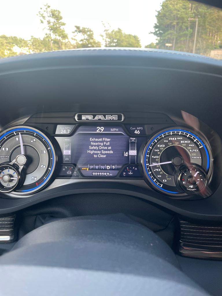

Something to share. I got this yesterday while driving my kids to taekwondo class. The speed was not exceeding 35 mph:

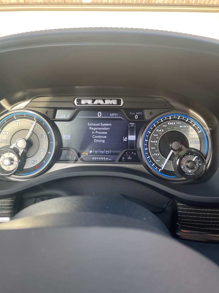

I left kids in the class and got back home (7 min drive) without turning the engine off and got this message:

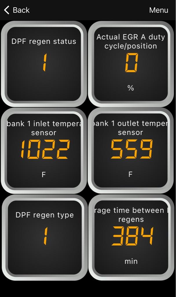

I checked temp and showed this:
I drove in neighborhood for another 10 min until message disappeared and temperature dropped to ~500 F.
This tells me that my truck can successfully do regen cycle at 35 MPH, right?
