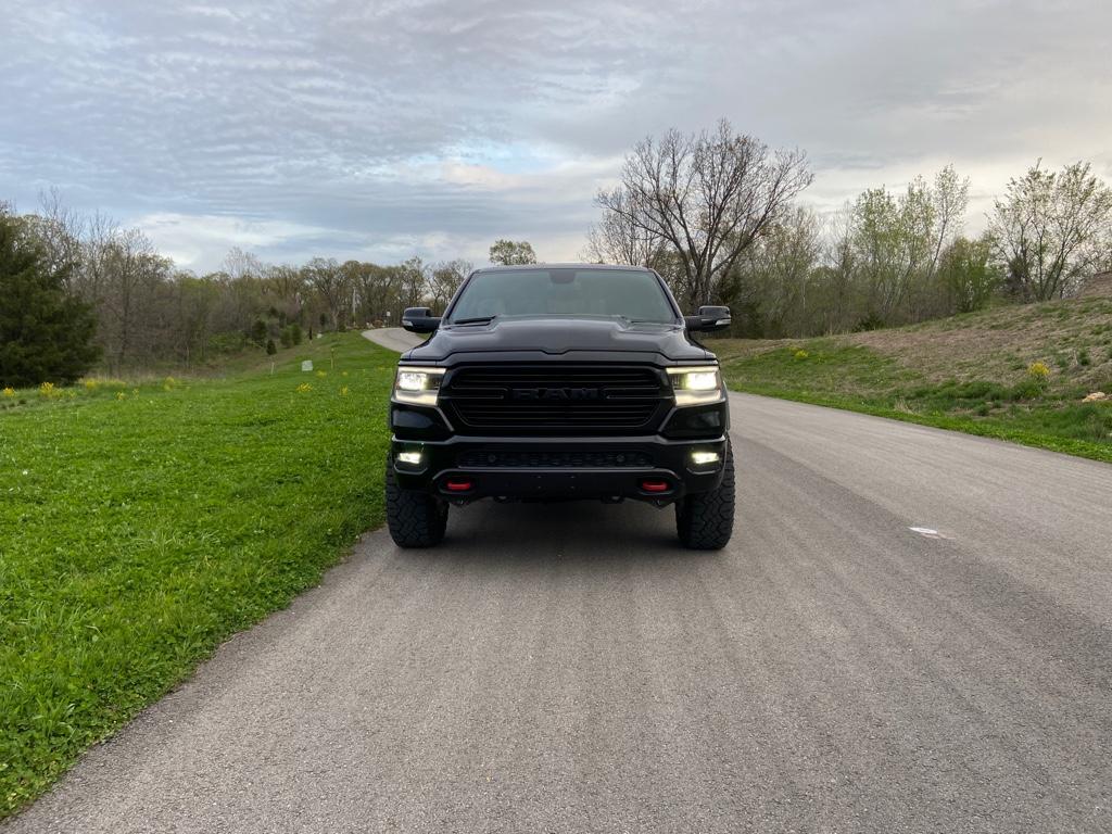

Yes, same would love to see the 1.5" spacer on a stock Rebel for comparison. The 2" looks almost perfect though but curious to see the difference. Also, @Ride2little do you have any issues with rocks kicking up and hitting the paint? I know when the wheels come out a bit that can be an issue sometimes.

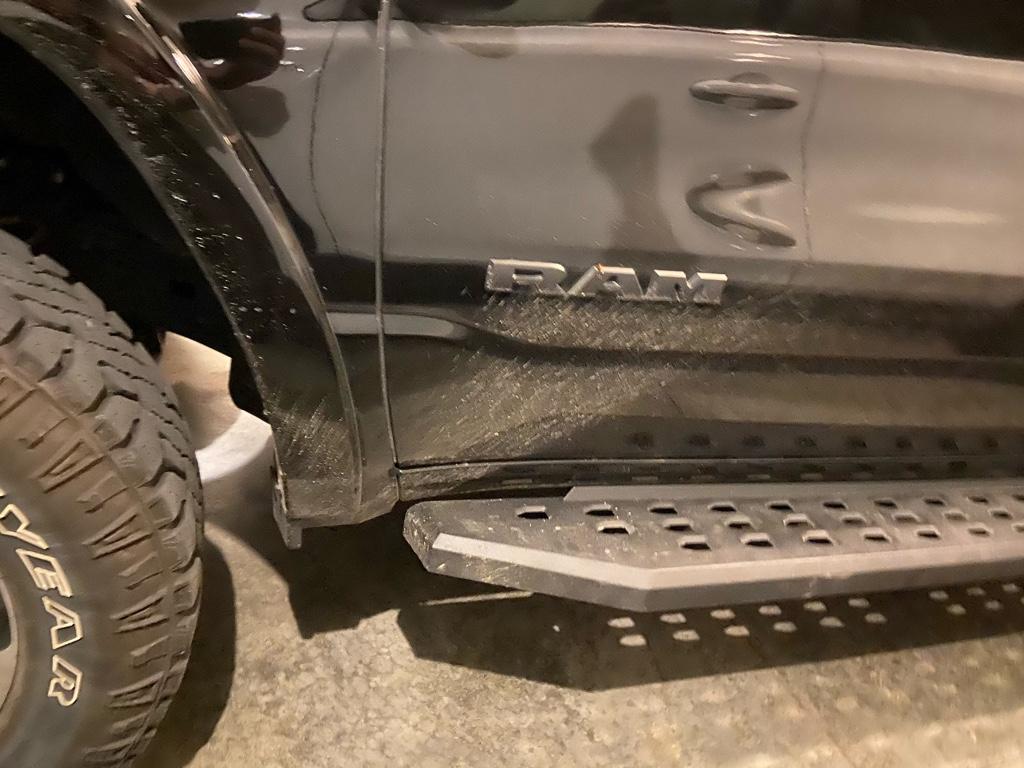

I have 2” spacers on mine (absolutely love them!). I’ve had them on a short time so can’t say for rock chips yet, however, I do know from reading on here that mudflaps likely won’t fit. I have running boards on which seem to capture most wheel toss up. Here’s a pic of some mud splash up. I can’t say how 1.5” would change this, but it seems likely some rocks could kick past my running boards.

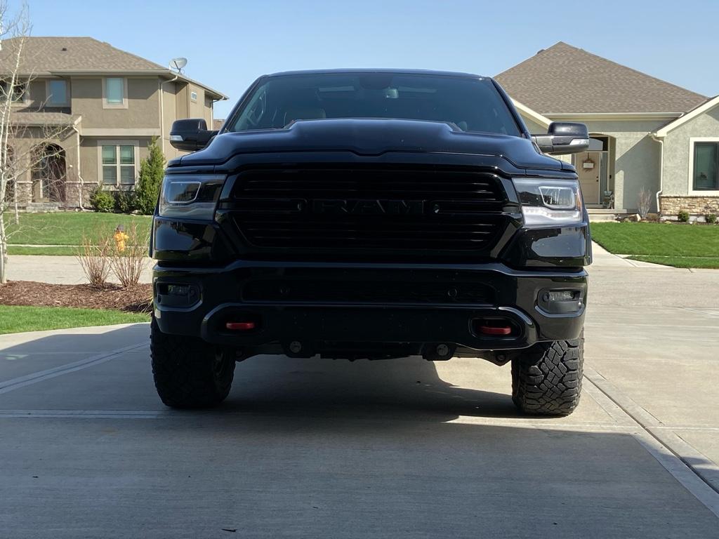

Just had my Titan 1.5” wheel spacers installed. I had called Titan and looked on their website. They specifically stated to torque the wheel spacers to 110ft lbs and use blue Lock Tight. I had a local brake shop put them on and watched to make sure they Torqued them correctly. They went on perfectly with no issues. Used my Stock wheels and tires. The spacers were black as well.

I have driven my Rebel now for several miles With the 1.5” spacers. I immediately noticed it’s a little more stable and cornered better with less lean in in the turns.
