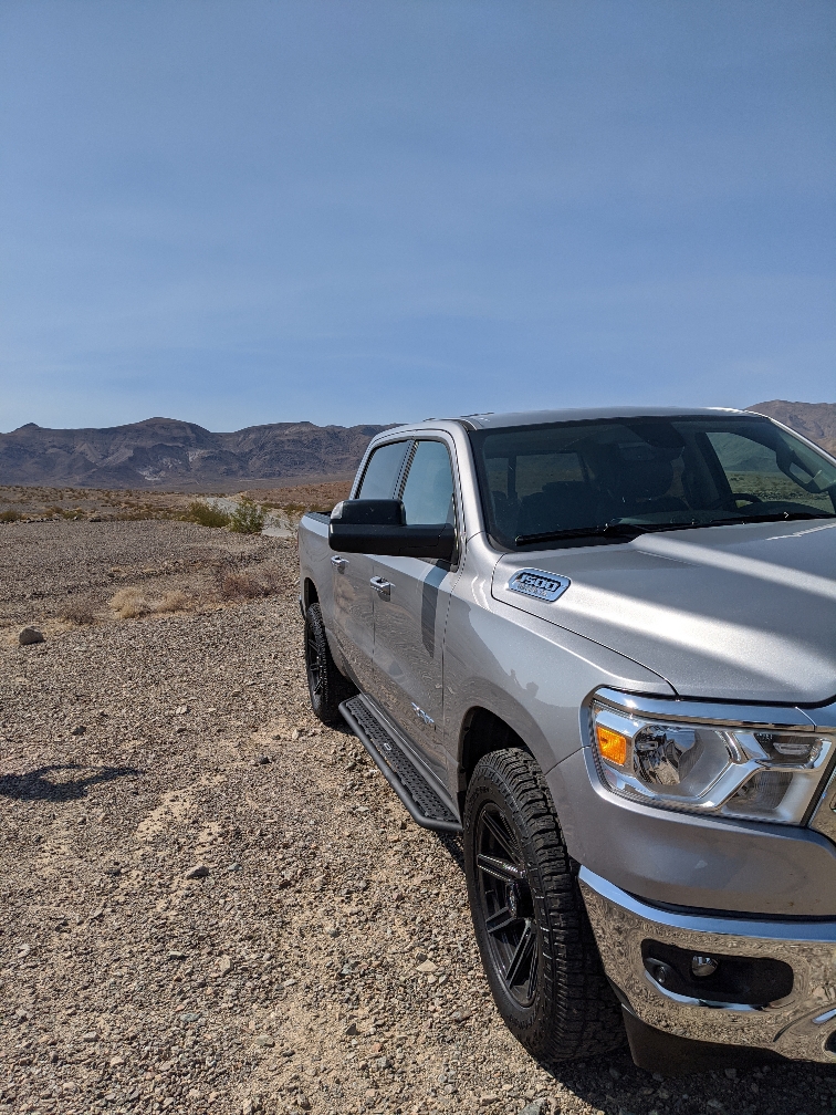

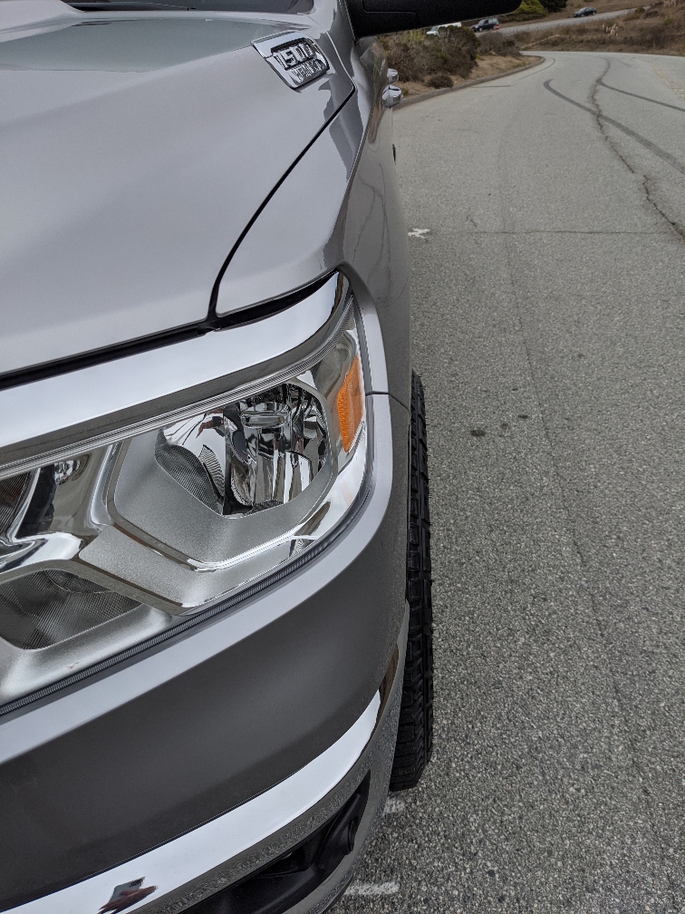

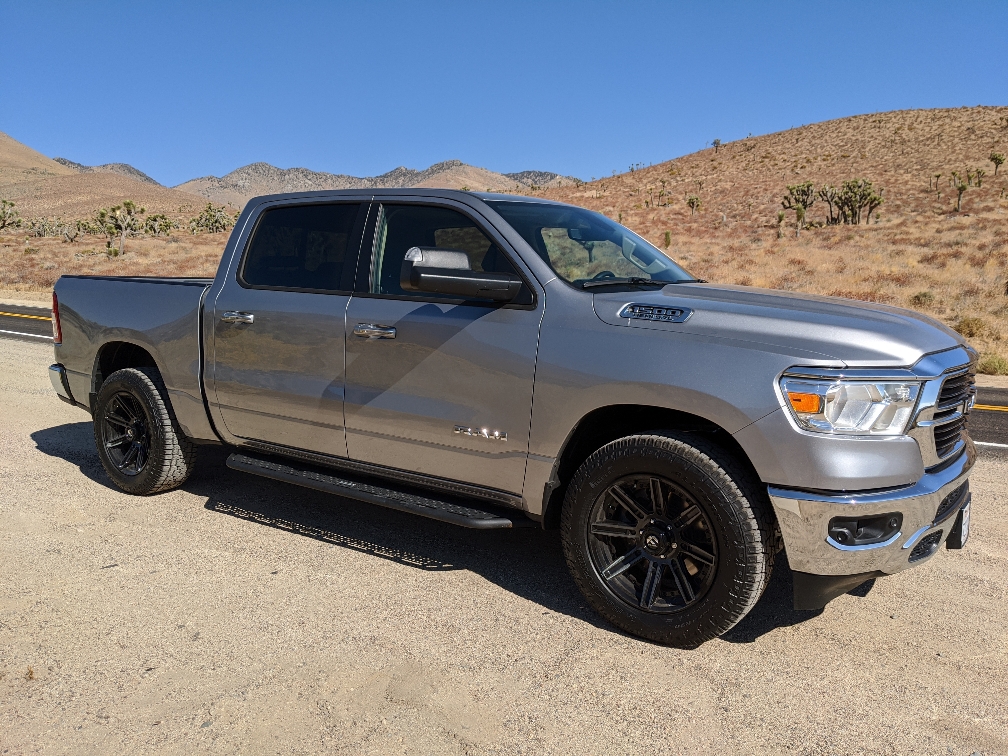

275/60 R20 on +1 offset.
Sent from my Pixel 4 XL using Tapatalk
Very nice! Do you have a level or is the rear dropped? And what tires are those? Love the look
dpdsurf
Aug 28, 2020
24
21
Thanks. Pirelli scorpion at+ stock suspension. It's a little higher in the rear.
