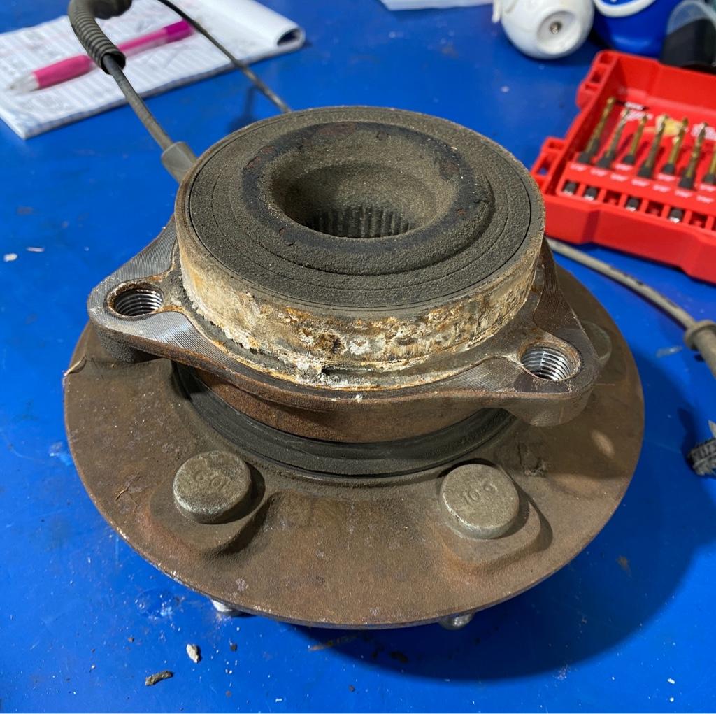

I just replaced the front passenger hub assembly this morning with a Mopar unit.

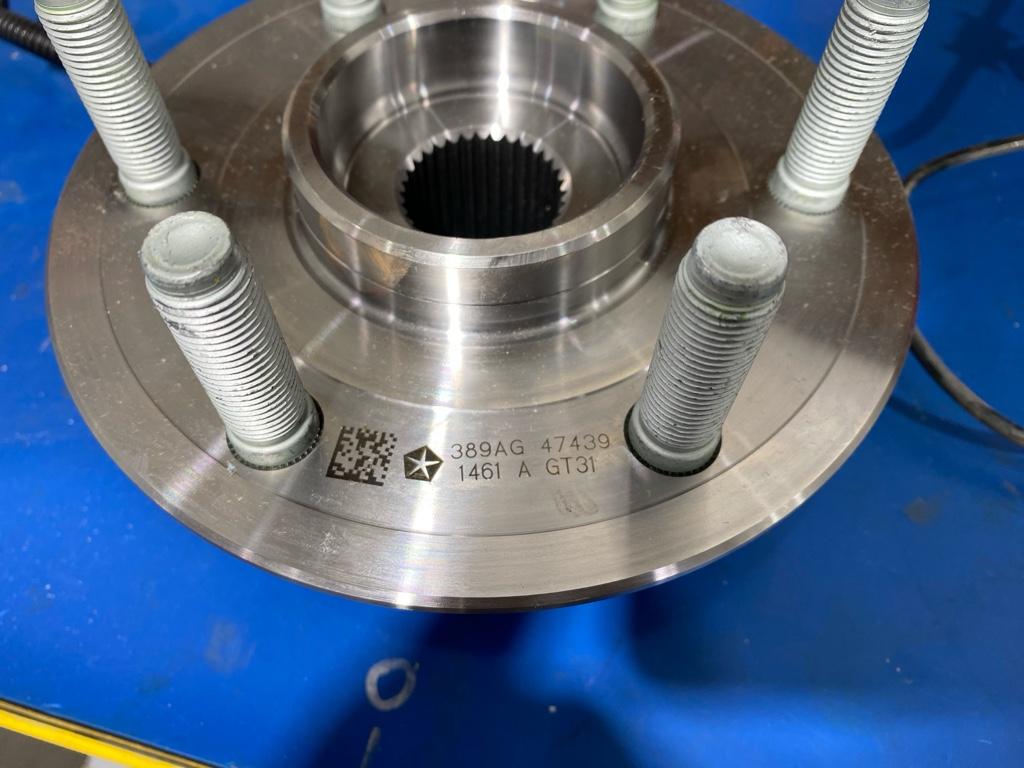

In my research, I found three different part numbers and costs but I believe that the issue was the revision of the part. My original order was delayed so I had to scramble and find something local before I leave for a 2 week work trip. The only assembly I could find in stock was 126 miles away and the old part number of 68339389AG. The cost was $399. Meanwhile, the new part that was out of stock would have been just $237. I’m told the difference is that the old part is side specific and the new part will fit either side.?.?.?
The latest part number is 68339389AH and I will post a side by side comparison of it to the original passenger side hub.

Mine failed at 111k but only because I threw the weights off the front right tire and ran it for awhile with the unbalance. I got new tires installed the day before I hit the road on a work trip. I felt a shimmy on the third day but travelled another 500 miles before I could get to a shop to get them rebalanced. The bearing started making noise shortly after that and was getting louder every week since. Drivers side is still buttery smooth.
Had the same experience on my 2002 Ram and had to replace a front right hub assembly around 200K miles. The left side was still OEM and smooth when I sold the truck with 326k miles on it.
