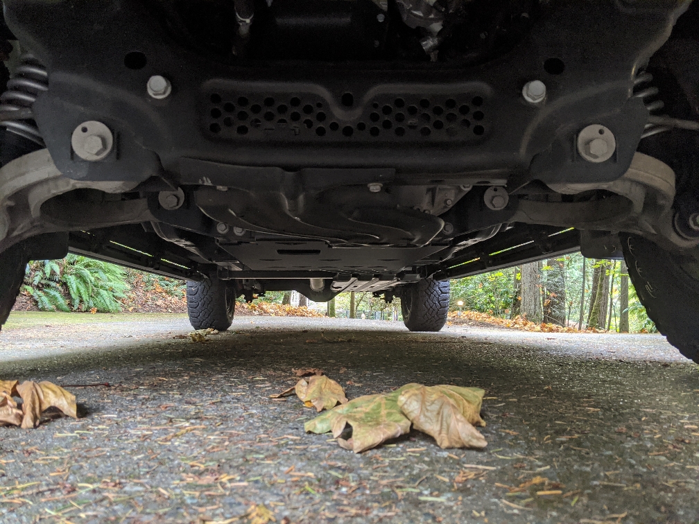

with the dethloff skid plate do you have some pictures of it on under body?
Here you go
