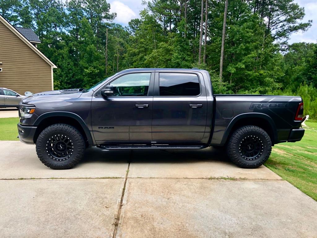

All 18” Methods fit just fine. I have Method Mesh 18x9 -12 on mine with Nitto Ridge Grapplers 35/12.50r18. I did some very very minor trimming to the small mud flap. Barely enough to even matter.

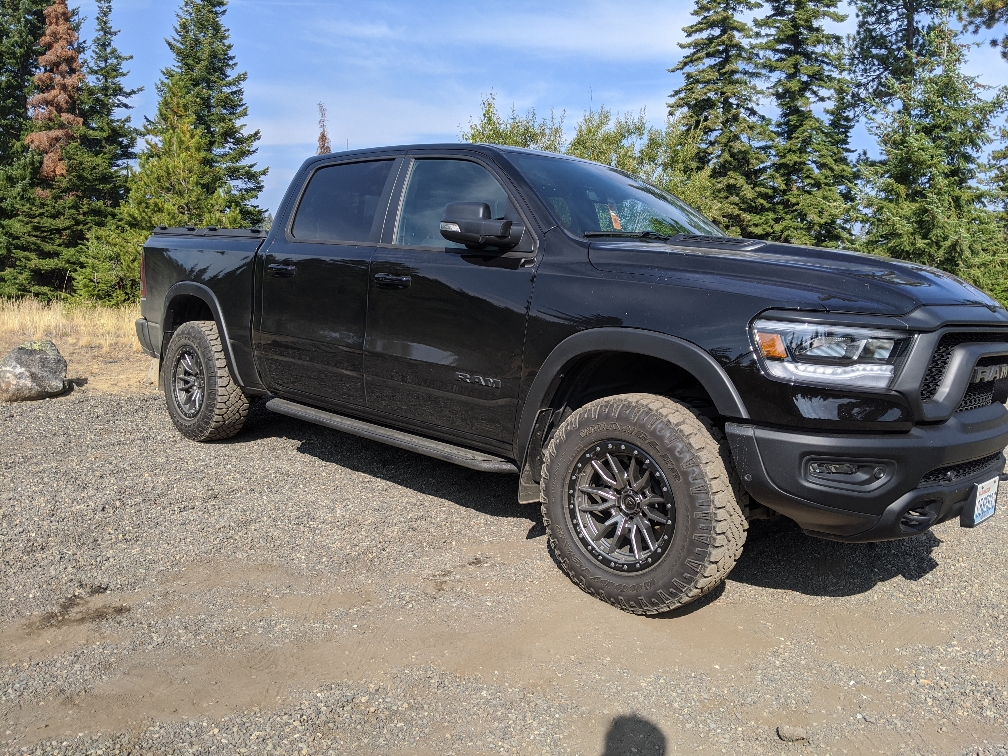

Fuel Tactic. 18 x 9 +1 offset.
Falken Wildpeak 285/75r18.
Also, the suspension has been upgraded to Falcon Sport/Tow/Haul leveling system. This would be a good upgrade for you since you are running around with a hell of a lot of weight in your bed.
Can you show a side shot? I have been looking at Methods, but am kinda lost when it comes to offset and backspacing etc. I want to get it right the first time. Plus, I want them to be at or near the edge of the wheel wells. The stock look is lacking.

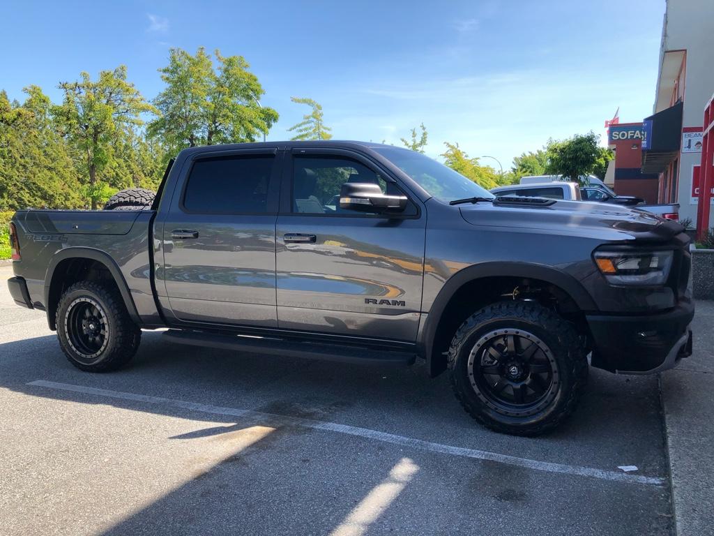

finally got my falcon lift and wheels/tires.
Went with fuel zephyr bronze 18x9 -12 offset
Tires are nitto ridge grapplers 33x12.5 talked to the guy at the shop and said if I went with 35s it would rub and would have to trim which I didnt want to do.
Also went with faclon level lift.
