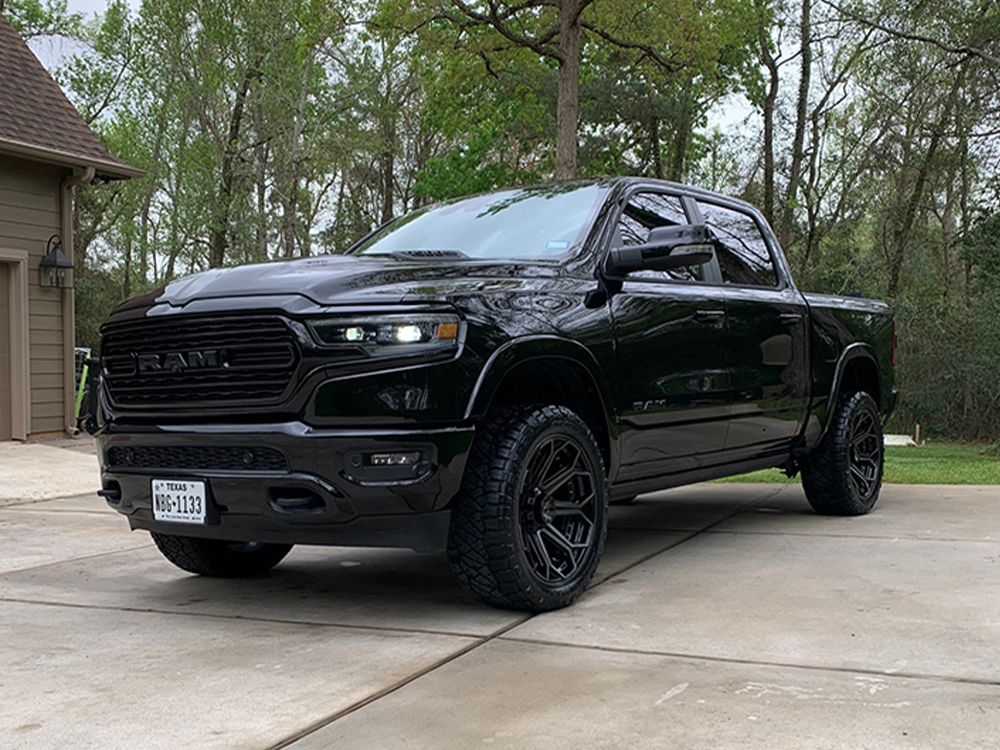

In general, you should be able to run 275/65/20's no problem on a stock truck with Air Suspension. Of course there will be outliers that will rub. I am getting ready to put that size on my 2021 Bighorn. At lease I think I am. I need to think it through a little bit more and figure out if it fits into my overall goal of the truck.
